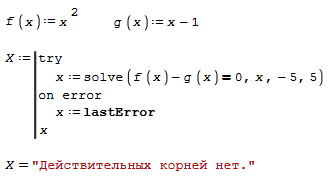

One option is as follows:
However, the error might still be due to something other than a non-intersection.

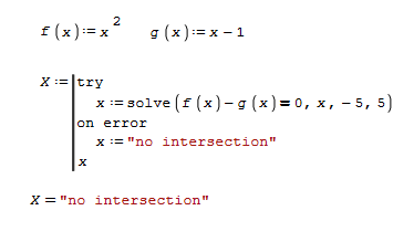

#4 Опубликовано: 29.09.2024 15:52:29
1 542 сообщений из 1 857 понравились пользователям.

Thanks a lot uni, now need to put everything in a conditionally formatted label and check the type of output if is a string or a number(s) to change the displayed message.
