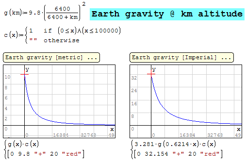

#7 Опубликовано: 16.07.2019 18:04:20
It is by default in Imperial units and I would like it displayed in Metric Units.
Maybe that's just what you want ... in vice versa system

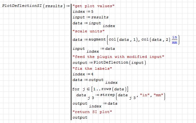

I don't see any public code for that plugin, so there isn't much to do on that side. However if really needed you might write some sort of "wrap function" to post-process the results and convert them to SI units.

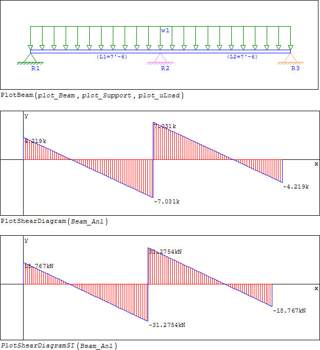

#14 Опубликовано: 19.07.2019 07:27:42
Either
  1. Scale the input values
  2. Process FEA results using the plugin
  3. Fix the labels
or
  1. Process FEA results using the plugin
  2. Scale the output values
  3. Fix the labels
PlotShearDiagramSI.sm (5,03 КиБ) скачан 1326 раз(а).
