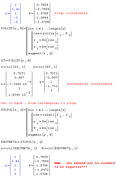

I know how to solve systems of equations of three unknowns.
I would also like to know how to pass vector of polar coordinates to rectangular and rectangular to polar coordinates.
thanks
#2 Опубликовано: 26.09.2011 21:32:39
Hope this could be the answer, If I understood you well:
Did I make any mistake here - pol2xy() can accept rho (distance) as negative ???
I think it might be wrong and should be suppressed.
