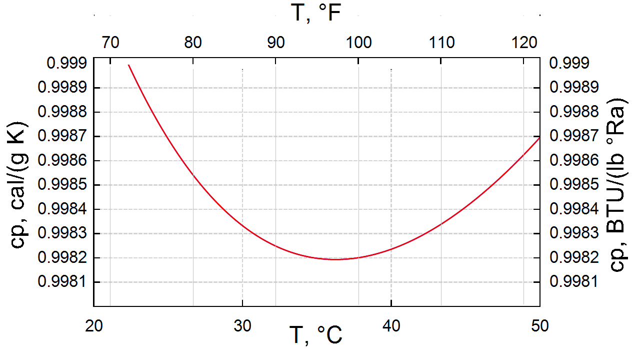

It will be good to have in SMath
2X-2Y.sm (12,9 КиБ) скачан 1834 раз(а).

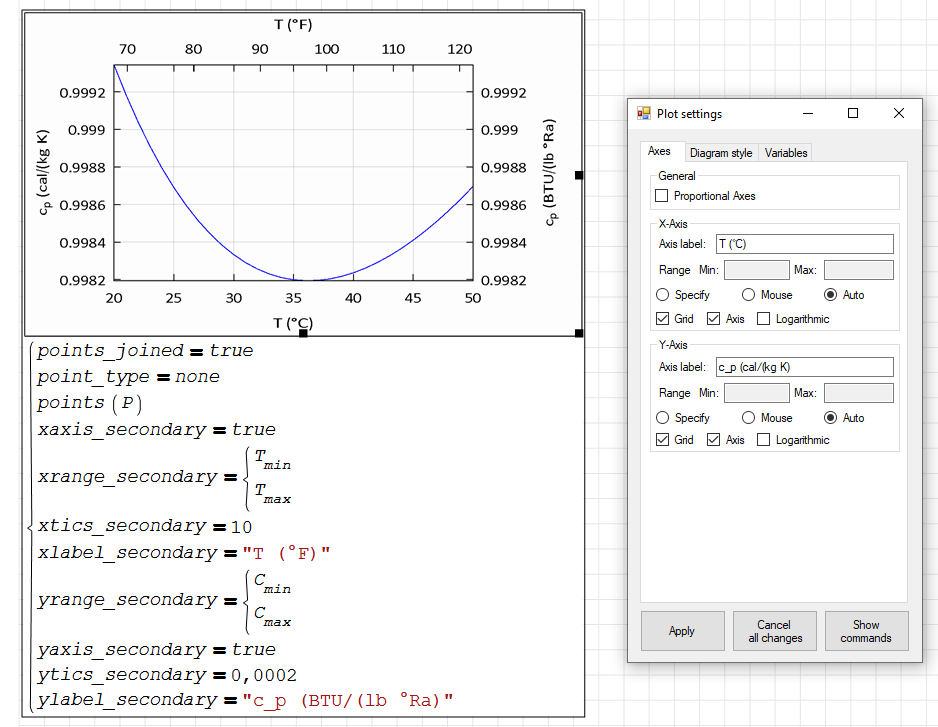

If you let in Maxima, then you can have it.
2X-2Y_Kr.sm (169,77 КиБ) скачан 1763 раз(а).
