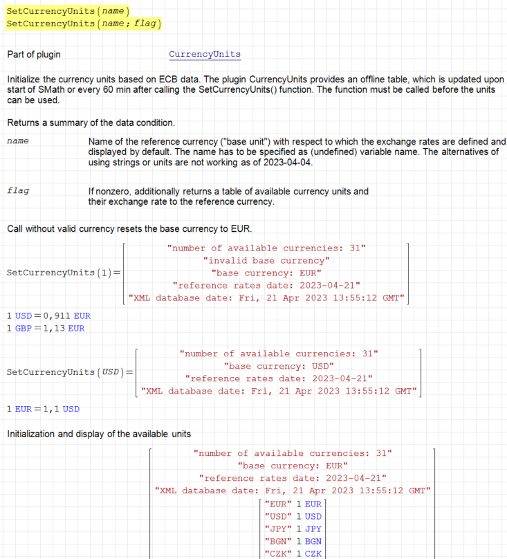

Here is an updated handbook page of the function SetCurrencyUnits().
In the current state, there seem to be some problems (filed as Bugreport SS-4686:
- SetCurrencyUnits(2) doesn't display the exchange rates
- The base unit must be specified as an undefined variable name. Units (even not the units defined by the plugin) or strings don't work.
- Russian rubles (RUR) seem to be missing.
SetCurrencyUnits.sm (19,8 КиБ) скачан 1894 раз(а).
![2023-04-23 21_57_02-SMath Solver - [SetCurrencyUnits.sm].png](/ru-RU/files/Download/UnRUxV/2023-04-23-21_57_02-SMath-Solver---[SetCurrencyUnits.sm].png)
