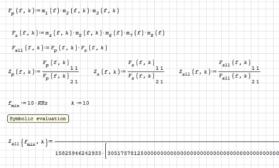

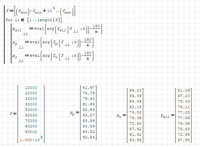

WroteThank you.
I was able to calculate the frequency characteristics
(PP2.sm)
But when I modify a circuit, I get an error even with eval.
(PPS.sm)
it's very difficult.
... sorry, can't help: this document opens freak SS 6179.
You seem to put too much that can't be debugged piece wise.

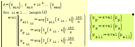

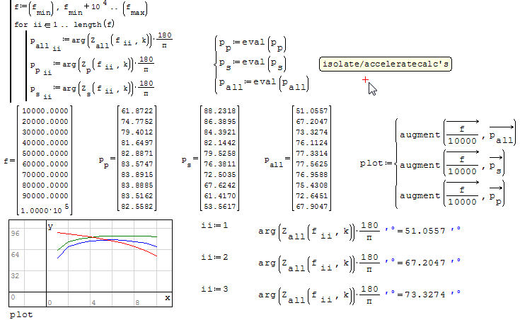

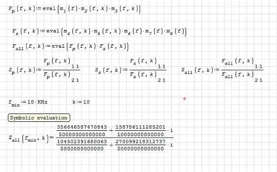

Hi Takez. Yes, it's very difficult recognize or even guess where the program needs some evals. Also, putting them everywhere make unreadable the procedures. In the case of your PPS.sm that's SMath stores into Z without eval
and this with it
So, for PPS.sm there is where you need to use eval, and seems that then all other calculations works.
