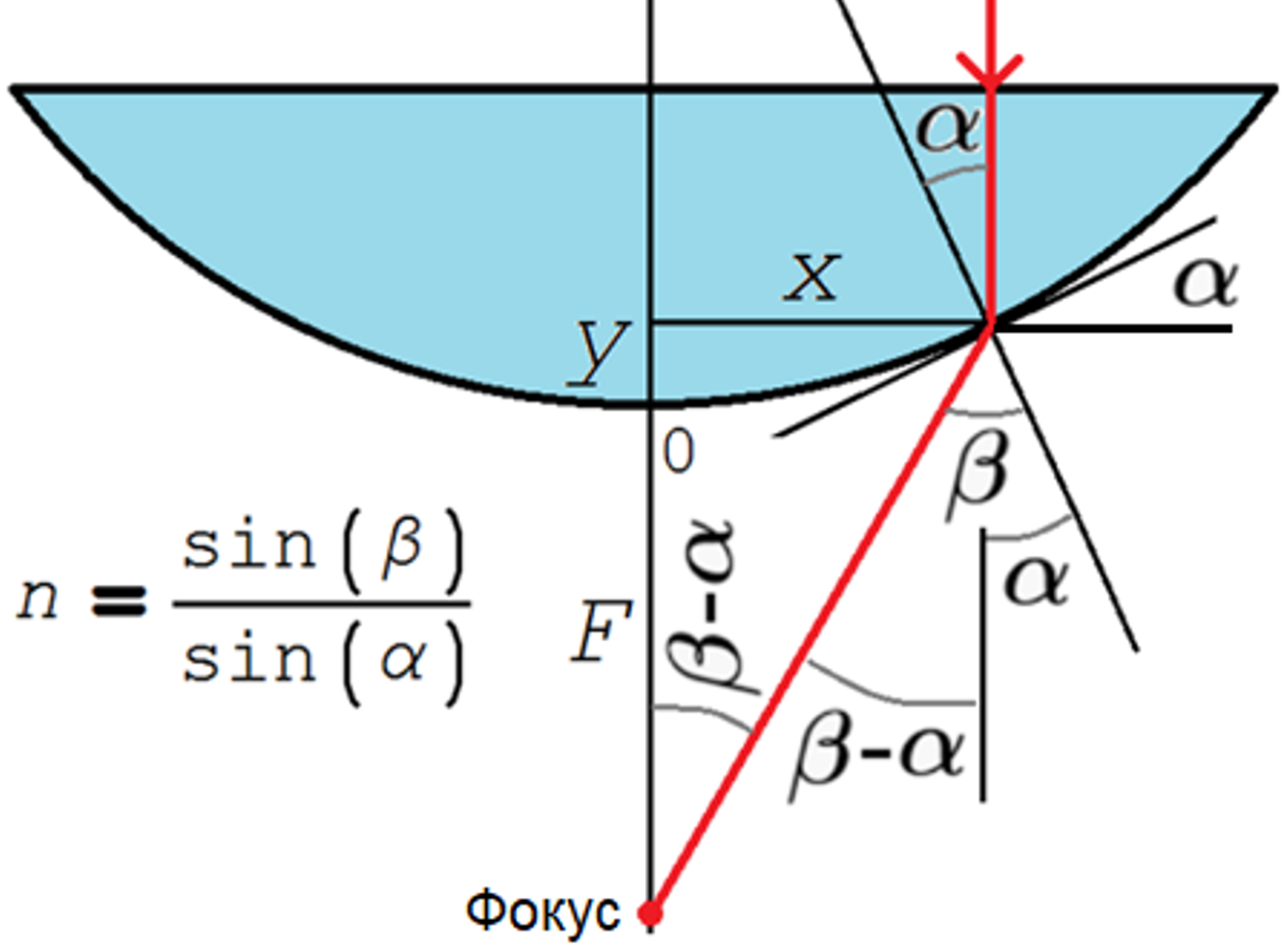

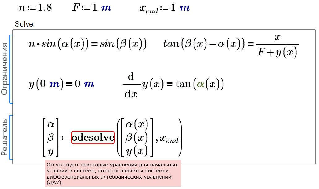

How can we use here a Mathcad-block?
Lens-Mathcad-Block.sm (43,8 КиБ) скачан 1796 раз(а).
See too
https://en.smath.com/forum/yaf_postst25212_Lens.aspx
#2 Опубликовано: 01.12.2024 18:08:12
Here the function rkfixed() can't process the incoming expressions correctly. The block has nothing to do with it, it does not perform detailed analysis of expressions.
This is a bug in the function. The function has not been tested for this case. I can't see what's wrong here right now.

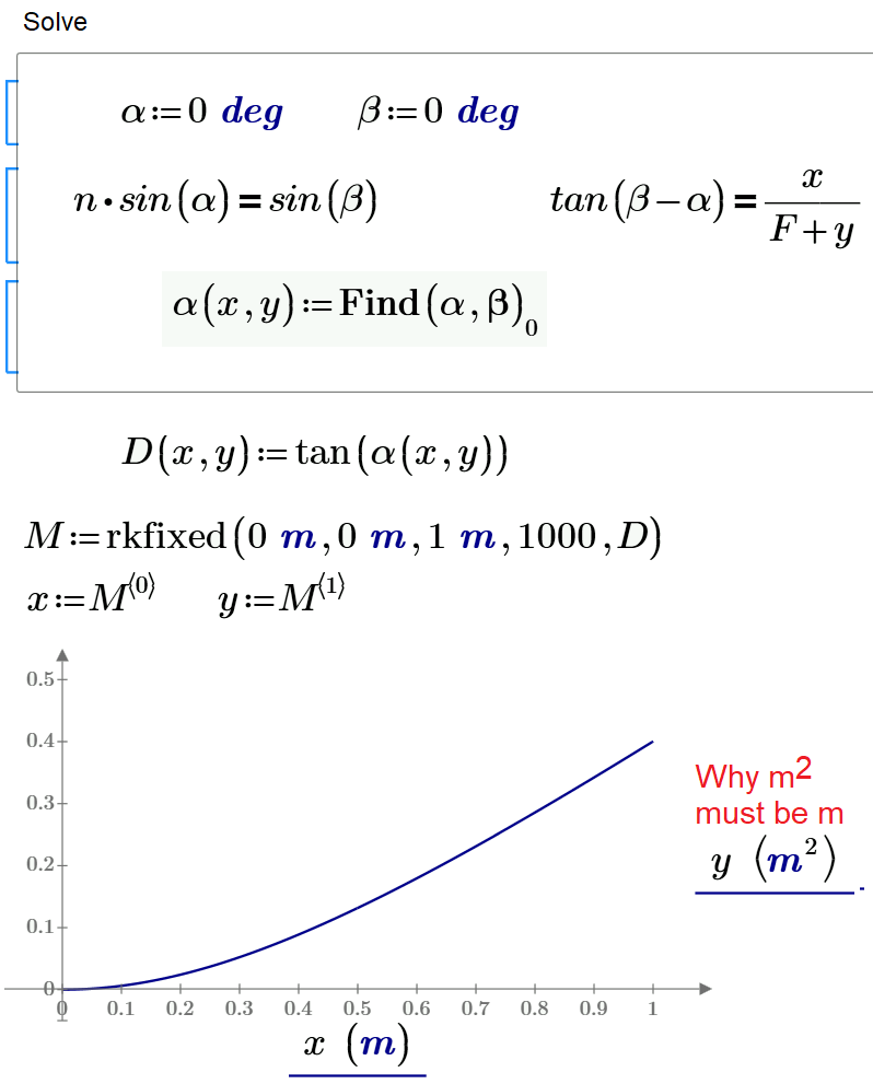

This is not a solution of the rkfixed problem, just a little playing around with X-Y plot.
Here, an option of setting the aspect ratio of the axes to 1 would be good.
Valery Ochkov 02.12.2024 15:45:00, francesco rapuano 03.12.2024 04:21:00

I am wondering if there is such a kind of Mathcad Prime odesolve for solving differential equations numerically also for SMath Studio somehow?
Not yet, but will be soon!
Question - why is the answer meters squared, and not just meters?
What's wrong with the existing solvers?
Because odesolve in Mathcad Prime:
1. Do not require to rewrite the differential equation of a higher order into a system of first order odes
2. Determines whether a system is stiff or nonstiff and then is using accordingly the stiff numerical differential eq solver or nonstiff numerical differential eq solver
3. Can solve numerically a system of differential equations (whatever it's a system of first order differential eq or a system of higher order differential eq)
What are these existing numerical solvers of differential eq in SMath? What are the posibilities of SMath to solve numerically differential equations? Exist at least one solver that mimic the Mathcad Prime odesolve (i.e. the 3 points above menționed)?

Hi Cornel. For points 1 and 3, SMath can do what Mathcad can, and just a little more. Please, check the first post in this plugin. Can mathcad solve this odes?
RKA.sm (308,62 КиБ) скачан 2194 раз(а).
RKA.pdf (931,16 КиБ) скачан 1668 раз(а).
About point 2, one would have to review the documentation for the following plugins to see if they are capable, and to what extent, of doing what you are asking, and choose it for the solver in the SMath's solver block.

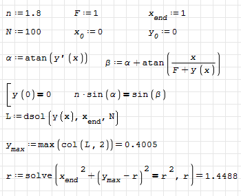

#10 Опубликовано: 08.12.2024 08:58:47
See too
Hi. dsol can solve it with this setup:
RKA-Lens.sm (179,91 КиБ) скачан 1769 раз(а).
I also use the Martin's setup for the plot.

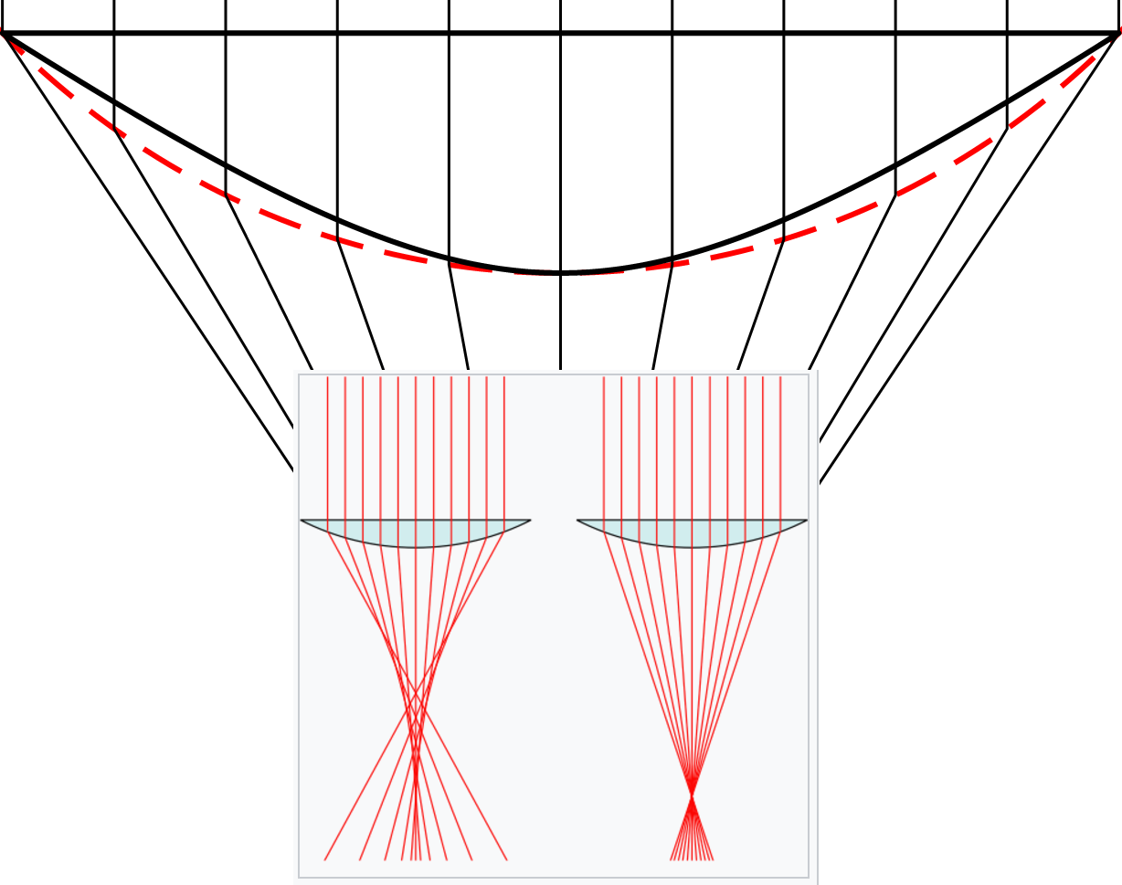

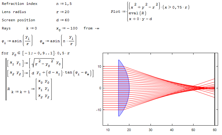

How to create this picture
https://en.wikipedia.org/wiki/Spherical_aberration
#12 Опубликовано: 10.12.2024 04:11:05
Hi Valery. This is a way.
spherical aberration.sm (15,88 КиБ) скачан 1756 раз(а).
Oscar Campo 10.12.2024 09:43:00, Valery Ochkov 10.12.2024 12:26:00

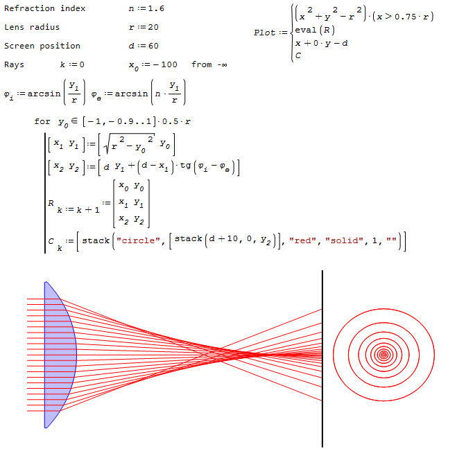

The last step
#14 Опубликовано: 10.12.2024 21:21:41
Hi. The screen. I also simplify a little the calculations.
spherical aberration.sm (26,41 КиБ) скачан 1905 раз(а).
francesco rapuano 10.12.2024 23:05:00, NDTM Amarasekera 10.12.2024 23:16:00, Вячеслав Мезенцев 10.12.2024 23:19:00
Very elegant solution
Alvaro 11.12.2024 06:18:00

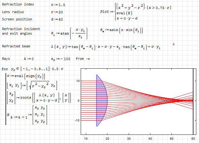

#16 Опубликовано: 11.12.2024 03:06:13
Root-free version of the spherical lens
spherical aberration_Kr.sm (12,37 КиБ) скачан 1687 раз(а).
Gracias Oscar! Pero espérate tantito nomás para que veas lo que puede hacer un doc alemán.
Thanks Oscar! But wait a little longer so you can see what a German doctor can do.
Oscar Campo 11.12.2024 12:09:00

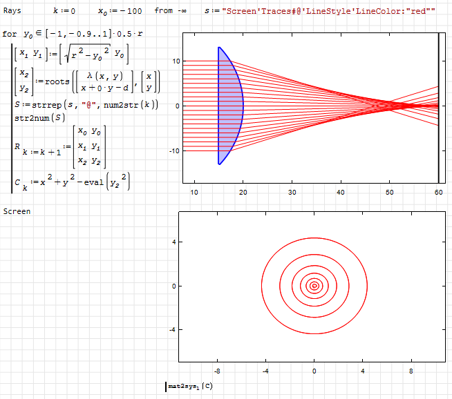

#18 Опубликовано: 12.12.2024 04:49:07
Oscar Campo 12.12.2024 18:29:00, Alvaro 13.12.2024 07:27:00
