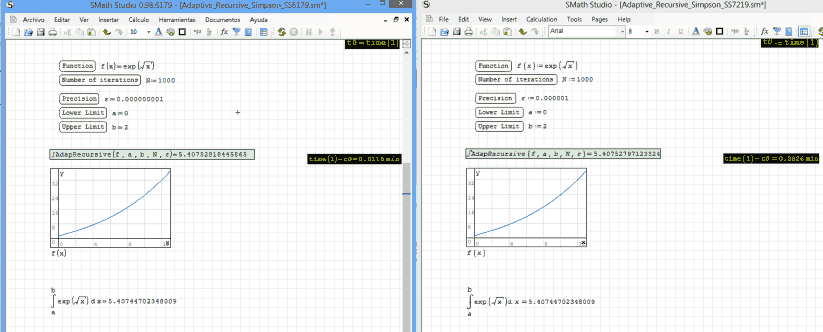

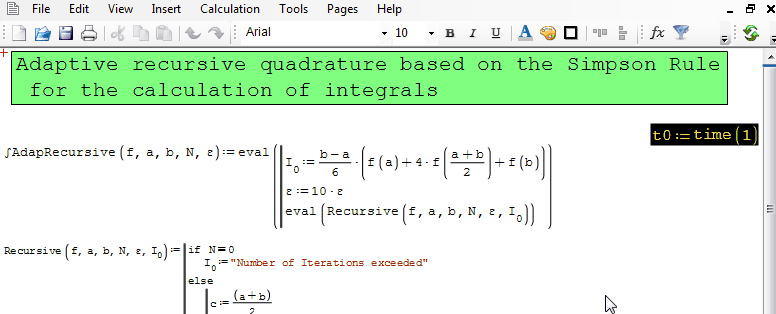

Here is an example of integration using the Simpson recursive adaptive method.
Adaptive_Recursive_Simpson_SS6179.sm (13,29 КиБ) скачан 1357 раз(а).
On the other hand, when running the algorithm in the versions of Smath Studio 6179 and 7219,
I realize that the SS-6179 version is more accurate than the current SS-7219, since the
first one allows an error of 0.000000001, while the latter only allows an error of 0.000001
Adaptive_Recursive_Simpson_SS7219.sm (14,55 КиБ) скачан 1324 раз(а).
The SS-7219 version cannot calculate the function with an error of less than 0.000001 to achieve greater accuracy.
Are we going back?
My native SS 6179 supports ε:=0.0000000000001
@ equivalent accuracy, Romberg-Simpson kernel runs ~ 8 times faster.

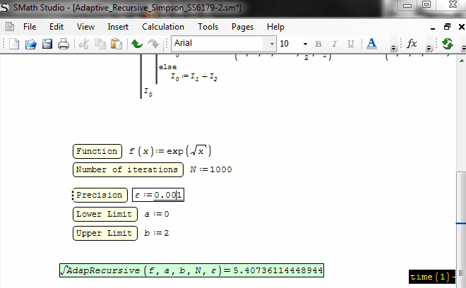

Strange thing happened to my Win7 machine (SMath 7219) and both files (by Carlos and Jean).
Running both files will just close SMath without any warning.
See this animated gif please.

Hello Jean,
Int() is going well but AdapRecursive() makes SMath to shut down when decreasing epsilon on my "kookoo" Win7
