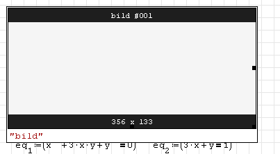

#2 Опубликовано: 18.09.2013 13:53:39
Thanks for your efforts , but I am not quite sure what this plugin is supposed to do? I can put it on the page, make a set, save it as PNG snapshots.
On the other hand, I can resize it horizontally, but not vertically.

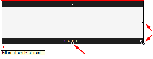

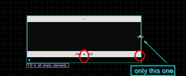

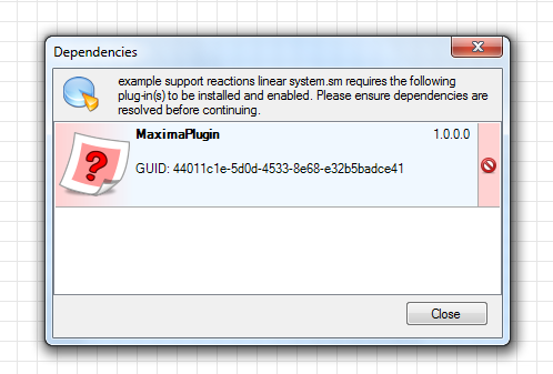

#7 Опубликовано: 18.09.2013 16:19:08
Davide, look at the first picture please - there is only one placeholder at the right side for resizing. I con not find the placeholder on tho bottom or at the right corner.
Martin, look at the second picture please. Where is this comming from . I just opened the file you attached to the previous post and this message box appeared. Is there any Maxima plugin in the development and not available at the moment?
#8 Опубликовано: 18.09.2013 17:16:15
Sorry for the confusion. LinSolve(2) is from Maxima, I forgot to switch that back to the snippet version LinSolve(1). Just remove the second argument, then the file should run.
The plugin is going to go public soon. One of our students is doing a great job with the coding work, I am doing the specification/docs and the testing. We just want to have the user interface (functions) to settle a bit. You find some doc preview in the SVN activebook. You can use the waiting time to install Maxima (plugin developed and tested under win only).
#9 Опубликовано: 18.09.2013 17:32:18
No, there are 3 placeholders, you can't see them because the background is close to black. From my smartphone and from my notebook (with sloping LCD) I can see both the bottom placeholders... don't worry, I'll make something - BTW if you move the pointer over the bottom-left corner or over the half width of the bottom edge the mouse cursor will change.

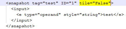

#15 Опубликовано: 20.09.2013 08:50:29
UPDATED
- can export the canvas tile (off by default).
* if you need to update sheets where there are Snaphot Regions, add inside the worksheet code the attribute
tile="False"
