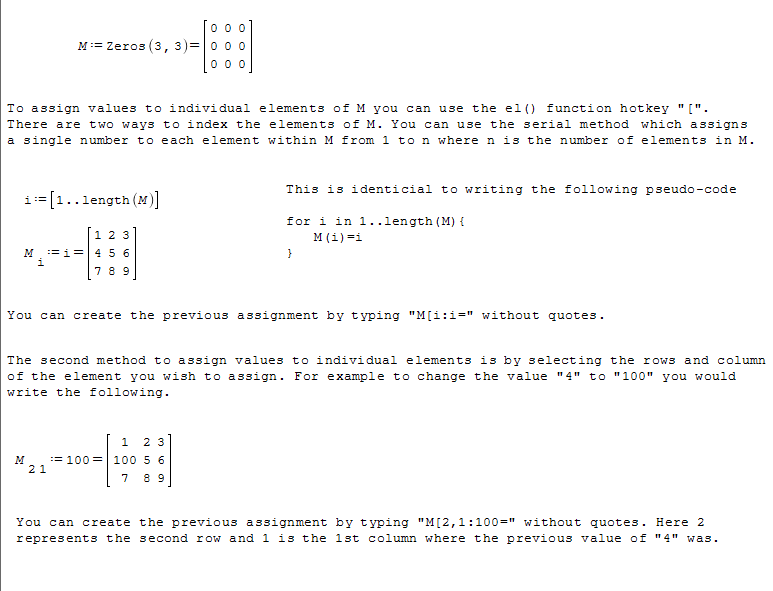

For example, it would be useful to be able to matrix element assignemnts instead of always clicking the matrix panel to the right.
Please take a look at the following file.
Matrix Example.sm (6,24 КиБ) скачан 1273 раз(а).

alyles:
THANKS! The last bit is what I needed to get el(3) instead of el(2).
