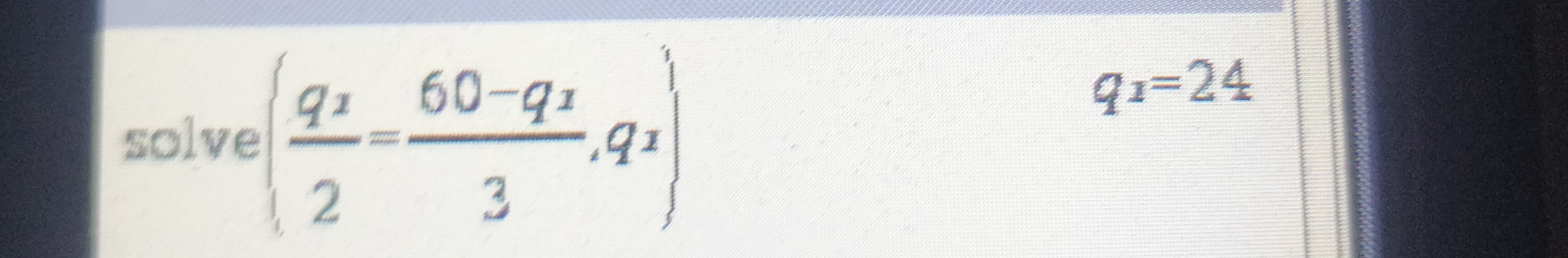

Is there any way to solve proportion's like in TI-nspire cx? (look at picture)

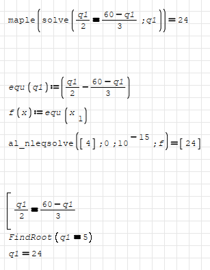

with Maple
or with Maxima

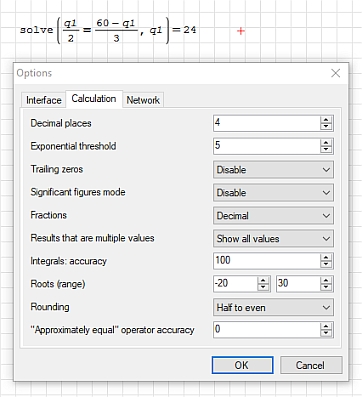

Hi. In addition to the churichurro solution you can also use SMath native solver after changing the roots range.

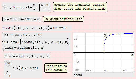

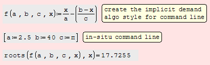

#6 Опубликовано: 17.10.2022 07:41:28
#7 Опубликовано: 17.10.2022 07:50:38
Solve Forum.sm (4,56 КиБ) скачан 1416 раз(а).

In addition to Razonar's reply;
You can also determine solve() range within the function itself.
You can also use roots() and FindRoot().
#9 Опубликовано: 17.10.2022 19:49:42
... get more, no sweat.

There are also plugin solvers.
Maxima can be added to collection as well.
plugin_solvers.sm (5,69 КиБ) скачан 1367 раз(а).
