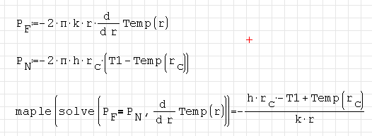

#23 Опубликовано: 02.03.2016 14:57:39
Maple Wrapper plugin can help with some symbolic problems.
Hello Uni,
Which one is right, which is wrong ?
Personally: I would scrap Smath from subscripted variable.

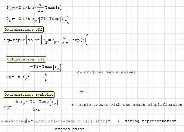

#24 Опубликовано: 02.03.2016 15:08:07
All answers are correct. I just have invisible braces. If you click on the expression, then they appear. I don't know why it happened.
#25 Опубликовано: 02.03.2016 22:43:40
I trust you Uni, because I know you tell the truth.
But an an algebraic result to be copied as such, wrong.
Maple does not like subsrcipt. That by clicking it shows
the brackets, to me it is a bug that it does not
output the right result.
I accept the subscript as a local tutorial demo.
For real work and particularly for publishing: NO subscript.
Cheers, Jean
#26 Опубликовано: 02.03.2016 23:16:00
I have a 30 page SMath file that does not run on 0.98; The error points down to the summation function
I the worst instance, I noticed Sum limited to N = 11
My Ksmoothlet takes over 100. I didn't pursue
the hypergeometric as it turned red at very low N.
Too low N for that is useless as it flies in the blue.
In the fft/icfft [about two months ago], the length of
accepted N is not constant. Puzzling, live with it.
Attach the part of the work sheet that points the Sum error.
#27 Опубликовано: 03.03.2016 01:22:33
Don't worry about subscripts. For the variables subscripts supported as was described here.
If Maple Wrapper meet a variable with the dot (comma) in its name this name will wrapped with the symbol `. You can see this in log file (\mvr5\mvr5.txt).
The log for int(x.1,x.1):

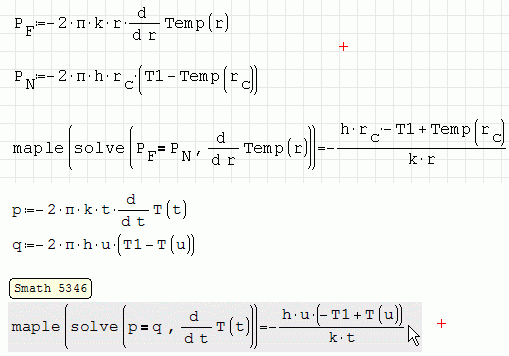

#29 Опубликовано: 03.03.2016 05:49:33
Why the 1rst display was wrong?
I don't know. May be Andrey will see this and make some comments.

#30 Опубликовано: 11.03.2016 20:32:51
2 343 сообщений из 4 057 понравились пользователям.
Группа: Super Administrator
Hello.
Thank you for figuring it out!
Issue was in Math Region. It is fixed now. Fix will be available in new SMath Studio build.
