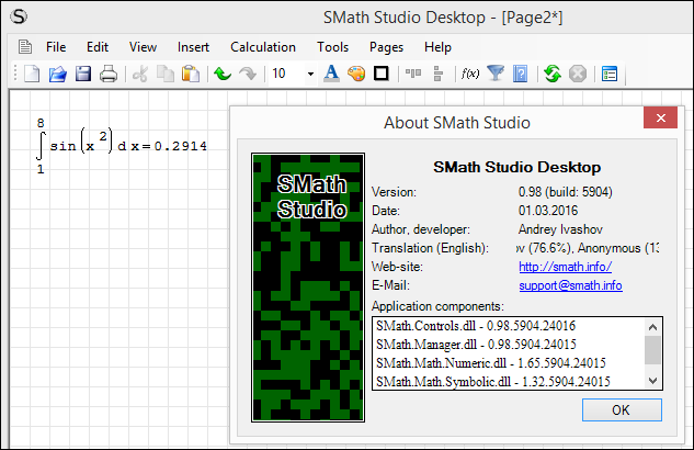

Everything works as expected for me:
Please help to reproduce.

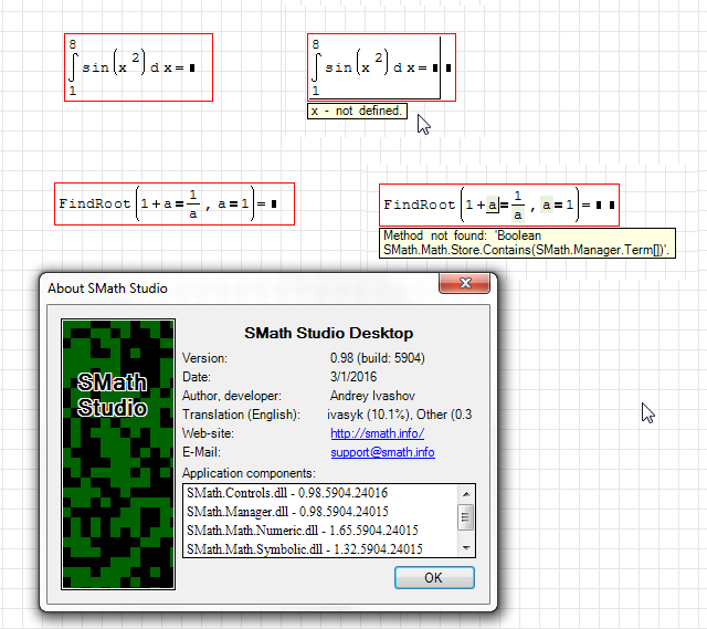

#12 Опубликовано: 02.03.2016 09:11:41
Hi Andrey!
Thanks very much for the new version.
I observe the following.
1. FindRoot function does not work.
2. Definite integral does not work.
It will not work for me as well, although I have to admit that I installed bunch of plugins.
However, fresh install with only Davide's Nonlinear Solvers (FindRoot() function is from there) and Martin's Smath Handbook will give this
1. FindRoot() will give the same error as on the picture
2. Definite integral works
Davide Carpi 02.03.2016 09:39:00

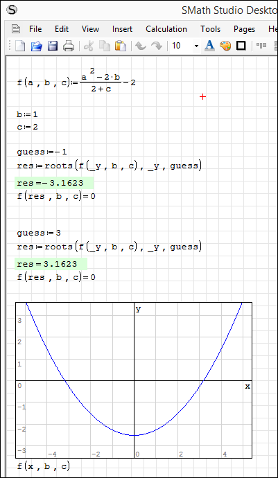

Cannot reproduce

#19 Опубликовано: 02.03.2016 11:29:36
NDTM Amarasekera
NDTM Amarasekera
Hi Radovan,
I had a bunch of so many plugins.
So, uninstalled, including all plugins in %APPDATA%/Smath folder and did a clean install.
My problem was solved.
Thank you very much.

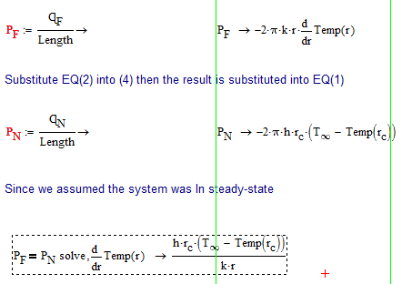

...Any information on the symbolics? I am trying to recreate a "proof" from a Mathcad file and I'm missing some features (or cannot find). Are we allowed to post Mathcad files on this forum? If so, I will post all of the relevant files.
Specifically, I thought that "symbolic solve of algebraic equations" was implemented in version .9X. Keywords in symbolics would be fantastic too!
From Mathcad
