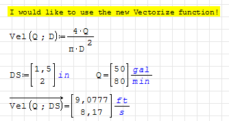

Jean will be proud (algorithm) and disappointed (would like to use vectorize)
I would like to know two things ... Vectorize and Program.sm (14,29 КиБ) скачан 1398 раз(а).
1) Can I convert my algorithm and use vectorize?
2) I want to pull the diameter that corresponds to greater than Vel.min

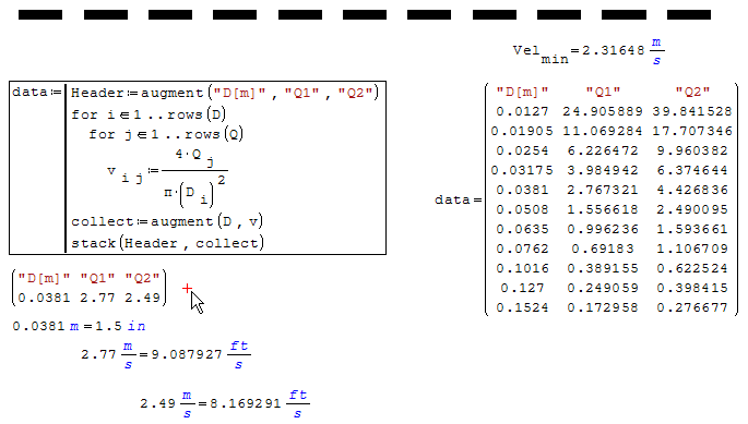

You can supply the data table to piping designers, and live them finish the work.
In 1987 and earlier, piping designer used a glorious software "Massbal"
At this time, none of these computing gadget existed. Vectorising does not apply
in your project. Smath is not equipped to search in table. For a unique scientific
application on long data table, one would have to design a lot of modules.

Thank you. Never used Augment before ...
Not for the piping designers, for me to double check other calculation. Everything is off of "packaged" software and I like to double check the maths. Curious if a second routing can be used to solve for the the D. If V.i,j>V.max keep solving, else, stop. Putting kids to bed and will look into that

Just remove erroneous declarations, and use DS in function invocations (your D variable is defined having 11 rows, Q has 2 rows, you should use DS having 2 rows).
Vectorize and Program.sm (14,58 КиБ) скачан 1409 раз(а).
P.S. My screenshot is just a follow-up of previous suggestions (Jean's and CBJ's).
My sheet is another approach without any loops, just vectorize() end eval().

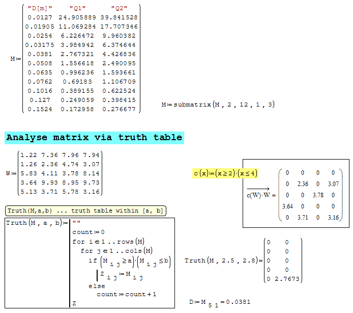

From what I can see, tabulating some sort of useful data will be the other way around .
The first column is the Q [massflow rate], from which you calucalte the speed versus
the diameter. So, there will be as many speed column as there will be diameters.
Doing so: the data table will be visual for checking. QA controllers, they don't care
gadget calculations, they go by the book. Also, consider what a CAS like Smath can do.
The truth table is not a gadget, it is almost the only tool to search in data table
that dont have integer values , though you can round off but can't surely round the speed
to integer values.

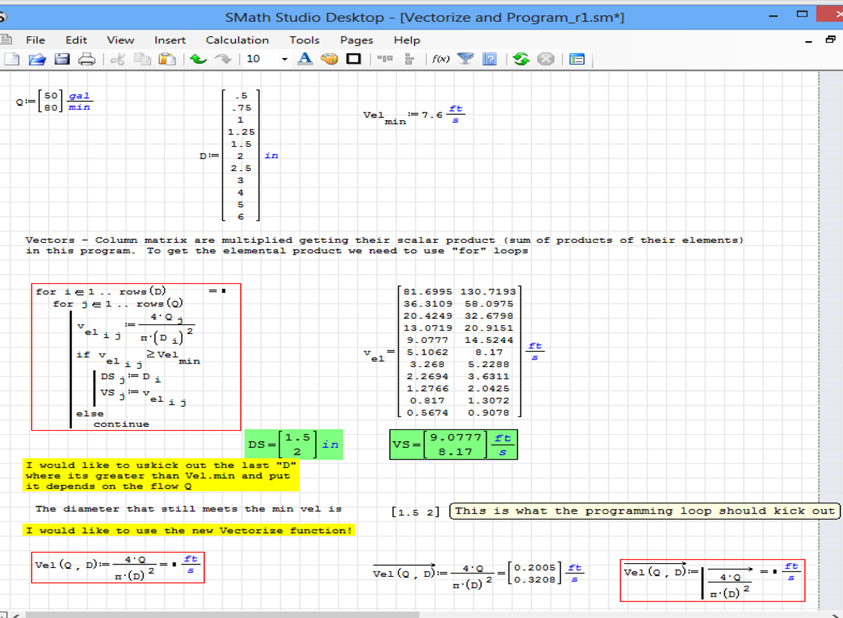

What's wrong with the counter? Getting "0" for first output, not 1.5.
Vectorize and Program a.sm (9,56 КиБ) скачан 1366 раз(а).
You have an error, the "Line " command should be in the second loop.
Annex corrected fileVectorize and Program a_r1.sm (9,57 КиБ) скачан 1404 раз(а).

Struggling with the matrices as I cannot figure out how to add components mid-way through the program loop. Right now, I drag down the handle, then individually cut and paste things down as necessary. If there is an easier way, please let me know

- CBG, you counter was what was perplexing me the most. This is originally what I was after Answer.smz (3,22 КиБ) скачан 1451 раз(а).
- Jean, you always say to be get inspired. After looking at your table, I expanded on my output Answer with Table.smz (3,64 КиБ) скачан 1462 раз(а).
