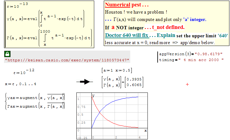

Gamma(a,x) User
Gamma(a,x) User - Gamma(a,x) USER - Сообщения
#1 Опубликовано: 10.10.2018 14:17:13
γ(a,x), Γ(a,x) ... read the document...
... mostly used in fitting data sets.
Γ(x) 15 Decimals [Abramowitz & Stegun].
Maths Special Gamma(a,x) Incomplete Quick Copy.sm (67,27 КиБ) скачан 1200 раз(а).

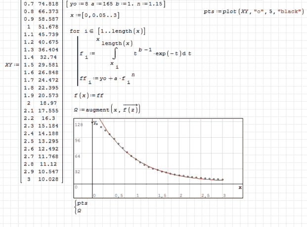

Playing a little test and error with the
coefficient y0, a, b, and n,
you get a better fit in the curve.
Maths Special Gamma(a,x)_Quick Copy_R2.sm (68 КиБ) скачан 1166 раз(а).

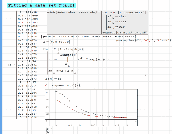

#4 Опубликовано: 13.10.2018 16:24:36
Thanks Carlos.
Here is an even better fit from your data reduction method.
Data reduction was introduced in the Mathcad DAEP [2003].
Kiby2 is stricking of realism ... attached.
More was done: linearisation of T/C [Thermocouple]
Genfit 000Carlos.sm (42,82 КиБ) скачан 1144 раз(а).
Genfit Kirby_2 [Reduced].sm (75,33 КиБ) скачан 908 раз(а).
