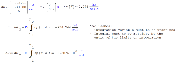

I have a problem with the integral. Please find the exemplary attached to this post. I have defined several variables and their units. In my opinion, everything is OK but SMath does not solve it when the temperature is defined as a vector T, or solve only the first integral if temperatures are defined separately (as T.1 and T.2). Can you explain to me why SMath cannot solve this integral?

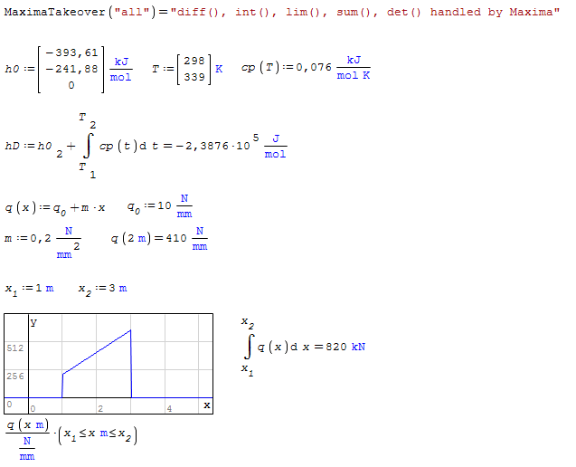

#6 Опубликовано: 01.04.2019 20:22:41
Maxima can handle integrals with units. Yet the restriction applies that the integration variable must be undefined.
int_issue_Kr_units.sm (10,14 КиБ) скачан 1170 раз(а).

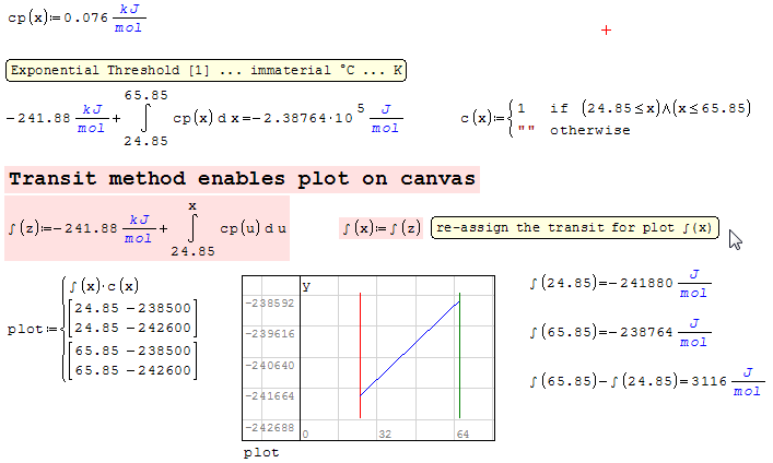

#7 Опубликовано: 01.04.2019 22:49:00
Native Smath does it in much greater elegance.
int_issue [Transit Method].sm (9,39 КиБ) скачан 952 раз(а).

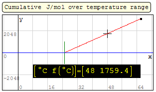

#8 Опубликовано: 02.04.2019 09:14:40
Refreshed version managed from annoying units
Integral 0000000 Transit-Units.sm (23,78 КиБ) скачан 1183 раз(а).
