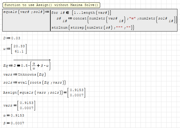

You can use roots() for your function. And a vectorize() can simplify it.
However, to use Assign() you will need this function to merge vars and solutions.
Assign_without_Maxima Solve().sm (7,36 КиБ) скачан 1260 раз(а).
Mo 05.04.2022 22:22:00

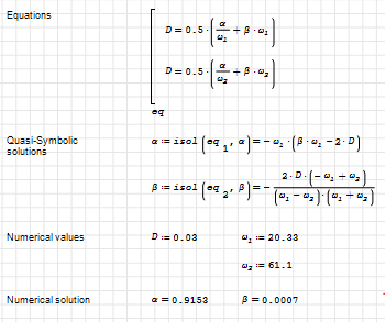

Greetings,

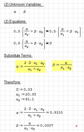

Another approach would be to use some elbow grease, you can substitute terms by hand and solve for 𝛼 and 𝛽:
Keypress (You can copy/paste the following into your worksheet):
α:{2*D*ω.1*ω.2}/{ω.1+ω.2}
β:α/{ω.1*ω.2}
*NOTE: ω.1 and ω.2 shown above are variables with subscript, they are not vectors ω[1 and ω[2; You should be able to substitute ω.1 for ω[1 if that serves your purposes.
- Kenny Lemens, P.E.

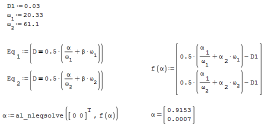

If the damping coefficients are denoted by α1 and α2, you can use the function al_nlegsoive
test.sm (6,99 КиБ) скачан 1277 раз(а).
sergio 06.04.2022 12:26:00, Mo 06.04.2022 11:57:00

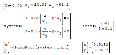

... more in there from native Smath code.
Solve FindRoot FORUM.sm (10,9 КиБ) скачан 1249 раз(а).

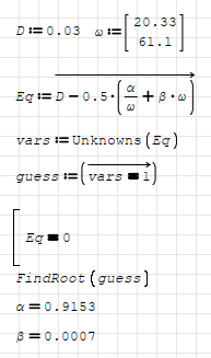

#10 Опубликовано: 07.04.2022 18:19:34
I think this is the most sophisticated method of my way.
It can get unknowns from equation, solve them.
In the end assigns numerical values to unknowns.
You don't need to define alpha or beta or any variable.
All process is automatic.
mathblock_v2.sm (5,19 КиБ) скачан 1261 раз(а).
There is also this way for guess define.
#11 Опубликовано: 08.04.2022 02:19:42
Fridel Selitsky
Fridel Selitsky
This is good, but for a system of linear equations(our case), the guess can be arbitrary.

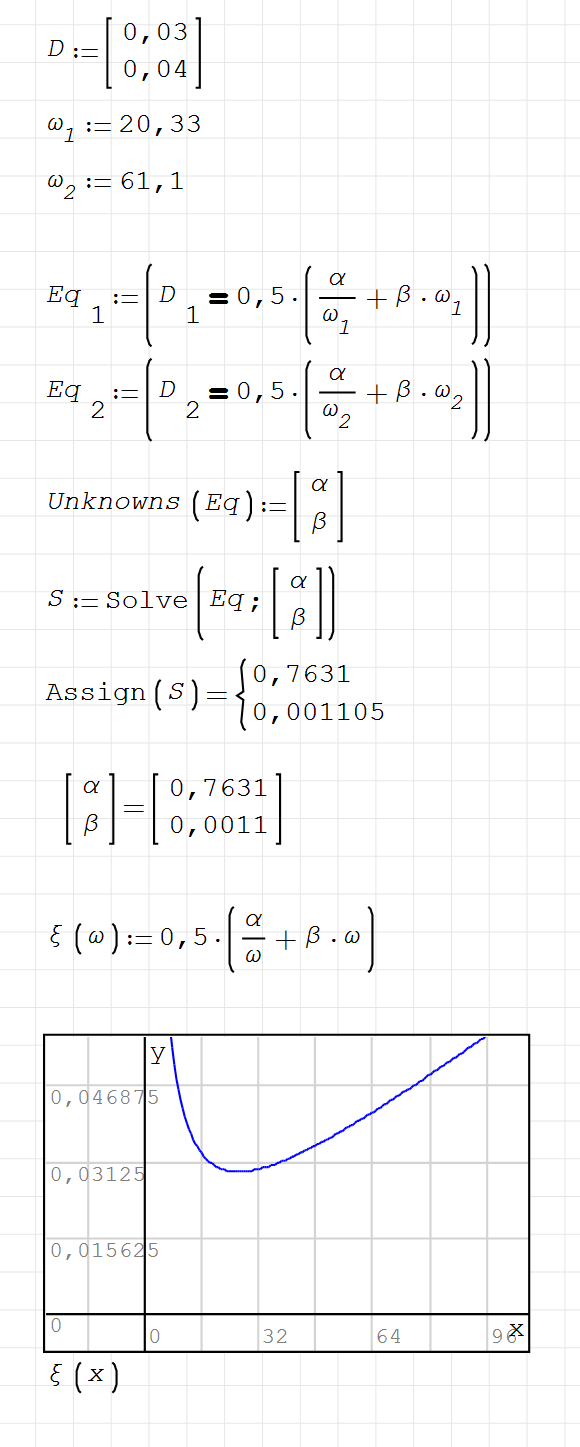

And finally a version with Solve() and list injection region:
mathblock_Solve.sm (4,86 КиБ) скачан 1216 раз(а).

Greetings,

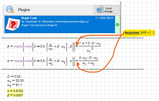

If plugins are considered, you can also consider the use of Maple:
In the image I posted, the 'equal sign' shown on those two equations are actually symbolic equals; keypress: [ctrl] + [.] instead of keypress [=].
Kenny Lemens, P.E.
