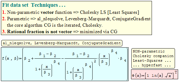

This document, freshly brewed, is a recast of the Genfit Procedure.
Now the fitted coefficients result from β:=Minimize(init,iter)
1. compose the model
2. assign the vector gradient
3. β:=Minimize(init,iter) ... done
The 3 examples are 1/1 MCD 11 except that "iter" is not automated.
By setting "iter" high enough that will worth automated.
The setup is identical to MCD where Minerr is applied to SSE from
the solve block Given/Minerr [CG, QN, LM options]

WroteThis document, freshly brewed, is a recast of the Genfit Procedure.
... refreshed for better publishing:
all respective modules collapsed in utilities.
This is a new example.
