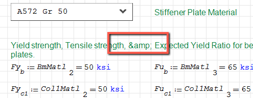

It also seems to be replacing symbols with codes like below, where it replaced "&" with "&".
Thanks!
Jason
Jason, thank you very much! Will fix it asap.
