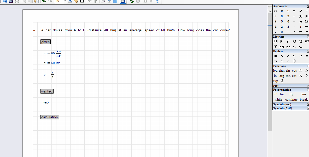

Hi Carlos! Thanks for the quick response. Your document works very well.
I tried to copy it, but unfortunately I failed.
I have created an animation of my work steps.
Maybe you or someone else can help me where I make mistakes.
Thank you very much and a happy new year.
Max
#4 Опубликовано: 31.12.2019 06:42:01
Max12
Max12
I've come to understand it by now. The unit is removed by multiplication.
It works now.
Greetings
Max
