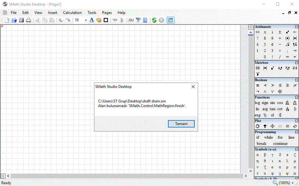

Smath Studio 0.98.5950 creates "MathRegion.finish" error for several worksheets of mine and files couldn't be opened. Same files have no error at version 0.98.5932 and perfectly opened. I have uninstalled 5950 and installed 5932 with same plugins and there were no problems at all.
As far as I witnessed I can open ".sm" files partially by disabling the plugins. The problems for my files are CheckboxList, ComboboxList, RadiobuttonList, WriterRegion plugins.
WroteThe problems for my files are CheckboxList, ComboboxList, RadiobuttonList, WriterRegion plugins.
I've updated these 4 regions for this SS version (many thanks to Andrey for the help via skype); let me know if you notice other issues.
P.S. WriterRegion is relased as Beta, it contains also several minor fixes not related with this SS update and a new option to choose when to popup the toolbar (Options > Environment). If all it works fine I'll relase these things also for previous versions of SS.
thank you for quick return, now it seems all plugins work as they are supposed to be.
