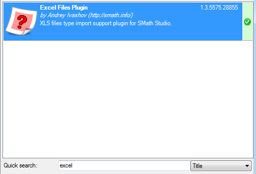

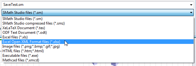

#2 Опубликовано: 23.02.2017 20:35:26
I guess it is "Excel file type" plugin by Andrey:
BTW it work for me
