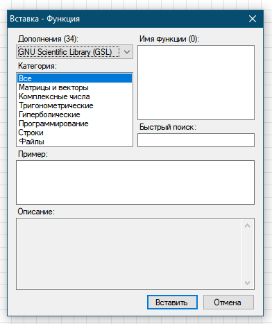

Плагин установлен и виден в SMath, но ни одна его функция не доступна. В чем может быть дело?
The plugin is installed and visible in SMath, but none of its functions are available. What can be wrong?
Windows 10 Home x64 21H1, SMathStudioDesktop portable (mono).
Upd: Разобрался. Нужен Microsoft Visual C++ 2015 Redistributable.
Understood. Requires Microsoft Visual C++ 2015 Redistributable.

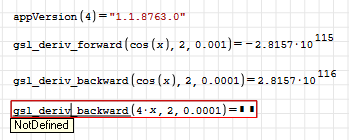

Hi Viacheslav. It looks like a bug.
#30 Опубликовано: 04.03.2024 14:24:55
As for the last error, this is by design. Function expected as first argument.
Click to enlarge
Here my results:
Click to enlarge
The problem may be related to this
Click to enlarge
I don't know exactly which one is used by the plugin. You can try reinstalling the Microsoft Runtime support library.

Hi Viacheslav. Thanks. I forgot to tell the operating system: Win10 32 bit. I check the 64 bit version and works fine, as you says. The library gsl32.dll seems to need vcruntime140.dll and msvcp140.dll. I see if I can update Microsoft Runtime support library also.
#33 Опубликовано: 05.03.2024 00:54:12
There really is a problem with the 32-bit version of the GSL. I can't debug the function because it gives me an error. This may be due to the project settings for building the 32-bit version of the plugin.
P.S. Only some of the functions in the 32-bit version of the library do not work.
Alvaro 05.03.2024 12:49:00

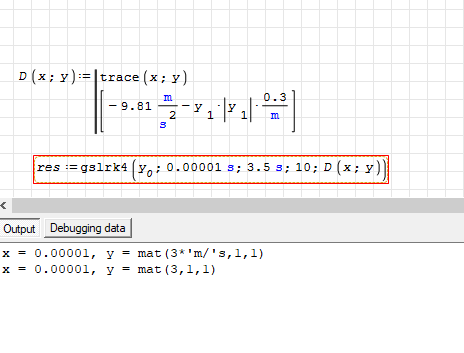

Would it be possible to correctly handle units in formulas. Right now, units are present in the first step but then stripped away breaking formulas.
#35 Опубликовано: 08.10.2024 22:51:35
I'll think about it. There are about 30 types of solvers supported now and I'll need to rework them all. If I can rework a few solvers, I'll use that experience to update the rest. But I can't promise anything yet.
