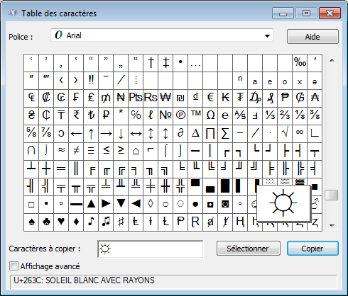

You don't need a plugin, just the right Unicode character (you can copy and paste the character from one site like Wikipedia, tamasoft.co.jp, alanwood.net or you can add the character holding the U and typing a #CODE# from the numpad)
look the attachments

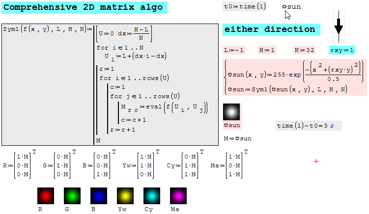

Hi. You can use this for not leave SMath and get the unicode chars that you want:
UNICODE_VAR.sm (2,45 КиБ) скачан 1271 раз(а).
Notice that you must to split the unicode char for preventing it substitution with the char itself when copy and paste the expression.

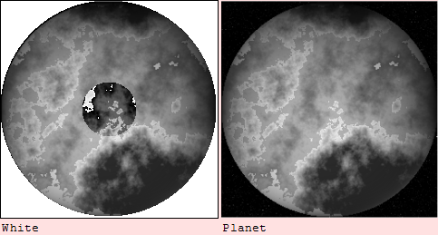

WroteIn astronomy I need to use a symbol that looks like a circle with a dot in the middle as a subscript
... from 6 years old .
Tentatively we can highlight a specific circular region.
The attached were left unfinished.
Image Planet Luminosity_1.sm (100,57 КиБ) скачан 1270 раз(а).
Image Planet c(planet)planet.sm (79,22 КиБ) скачан 1267 раз(а).
Image Planet fmap.sm (183,45 КиБ) скачан 1288 раз(а).
Image Planet Luminosity.sm (219,14 КиБ) скачан 1223 раз(а).
Image Planet Luminosity_2.sm (236,04 КиБ) скачан 1250 раз(а).
Image Planet Gamma.sm (315,73 КиБ) скачан 1297 раз(а).
