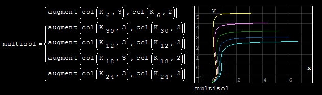

3. If you delete the if/else and conserve augment(col(el(K,tt),3),col(el(K,tt),2))
you can have each individual "Frame" by setting tt => 6..30 and export each
individual "Frame" solution.

#11 Опубликовано: 16.08.2016 00:31:23
... like this:
#12 Опубликовано: 16.08.2016 01:11:51

Merci Jean! I will need some time to explore your explanations. My level in maths does not allow me to understand the difference between Dragilev and Runge-Kutta! And I like to use the latest version, since someone has worked on it! (Not always true, sometimes the newest version is a deliberate, clever sabotage of the previous one, but at least it's true for such a honest piece of software like Smath!)

Cher Jean: CA MARCHE! It works.
I have uninstalled the latest version (which Andrey says is beta) and tried with 5346 and your modified worksheet works just fine. The way you have rewritten it is very interesting. Thanks for that!
Your "compactum" method -in my understanding- is that you have actually defined a function, which is interpreted at a later stage with whatever values in the variables that you want. It works with parameters as well as with global variables. A little like LISP, SMath evaluates a function only when it has to. It's very helpful, you can define whatever you want as a preamble without worrying if the variable exist or not, etc.
A very interesting point: Your modified worksheet works also perfectly well with the latest "stable" version, 5935. I guess that's why Andrey differentiates between "nightly builds" and "stable"!!! There is so much work to make these things turn smoothly, I can't imagine!!!
