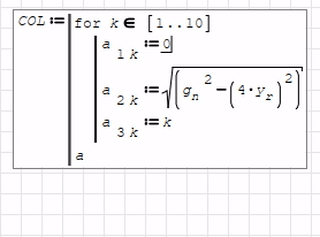

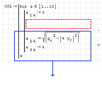

Folks, I have another query please and am grateful for help.
As per diagram below, how do I move several lines down and create space for another equation inside my "for" loop.
#7 Опубликовано: 25.05.2021 20:22:23
Use your arguments separator for this.
This works also for vectors but not for matrices.
#8 Опубликовано: 25.05.2021 20:57:18

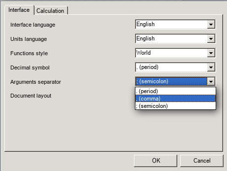

thank you, but can you please clarify what exactly is the "arguments separator" ?
#10 Опубликовано: 25.05.2021 21:12:44
It depends on your setting.
Its setting is under Tools > Options.
I use semicolon, default is comma I guess.

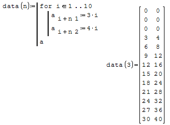

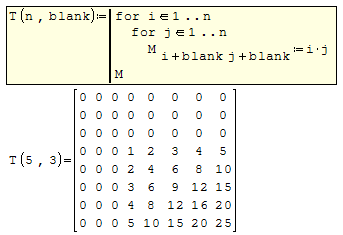

#11 Опубликовано: 25.05.2021 21:22:37
how do I move several lines/cols down/right and create space
#12 Опубликовано: 25.05.2021 21:33:27
Page12 Ravel Matrix.sm (9,46 КиБ) скачан 1408 раз(а).

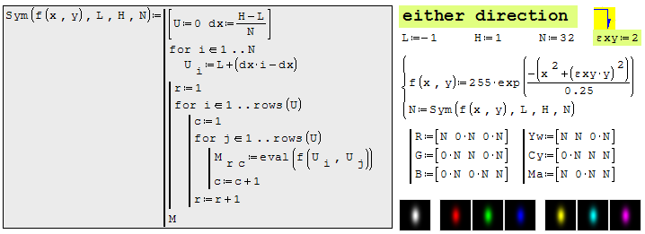

#14 Опубликовано: 26.05.2021 20:07:15
This is like Schrodinger's answer, both right and wrong at the same time, lol.
I greatly admire that you have recognized
the long functional romance was Shrodinger lol !
Otherwise coded from Mathcad ODEsolve .
Maths Schrodinger.sm (67,54 КиБ) скачан 1204 раз(а).
