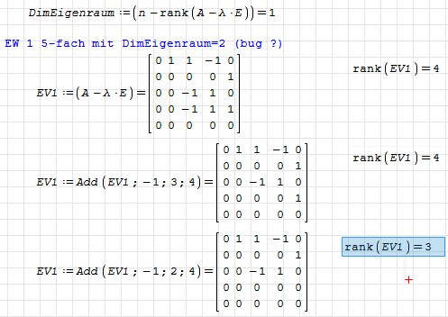

Hallo zusammen,
DimEigenraum: (n-rank(A-λ*E))=1@#
should be 2
some steps of elementary row additions later
is 2
https://de.smath.com/cloud/sheet/vooDFR4FbP
any idea whats wrong?
should be 2
is 2

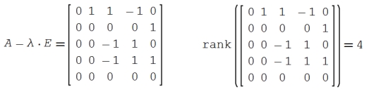

Maxima pure
(%i6) A: matrix([1,1,1,-1,0],[0,1,0,0,1],[0,0,0,1,0],[0,0,-1,2,1],[0,0,0,0,1])$
(%i7) A-1*ident(5)$
(%i5) rank(A-1*ident(5));
(%o5) 3
but
Maxima(rank(A-1*identity(5)))=4
or

rank(M) ... matrix rank is Smath built-in.

and in how far do your example explain the incorrect calculation
WroteThe referenced sheet seems to use Maxima(). This doesn't work, as third party plug-ins aren't available in the cloud version.
It is better to attach such files here.
the Maxima part calculate the single eigenvalue which is set manually in cloud version

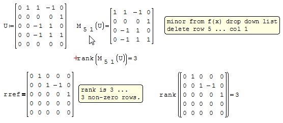

Wroteand in how far do your example explain the incorrect calculation
Just advanced maths above the classroom.
Your example replies bug from incorrectly threaded input.
As given, your [5*5] matrix has no mathematical meaning.
Page1 rank.sm (11,74 КиБ) скачан 1372 раз(а).
