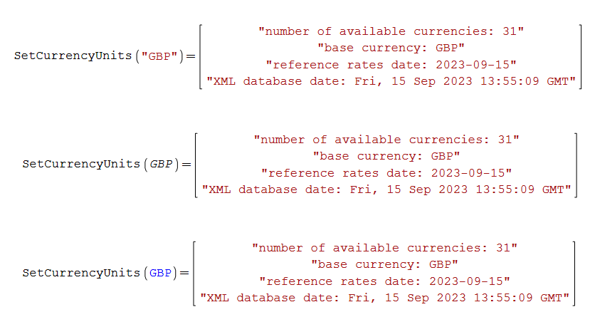

#6 Опубликовано: 15.09.2023 17:48:11
Hello, The SetCurrencyUnits() function is not posting the current rates.
Fixed both SetCurrencyUnits(1) and SetCurrencyUnits(2), plugin released for latest version of SMath Studio stable.

#8 Опубликовано: 18.09.2023 05:08:57
my date now posts: "reference rates date: 9/22/2022 12:00:00 AM" and "XML database date: 1/1/0001 12:00:00 AM".
I am currently running 1.0.8348.30405.
That's odd. I'll check if I can add some sort of log to investigate the reasons. It might be a firewall problem?
I assume this is the latest stable release?
Yes, the plugin is fixed for the latest SMath Studio stable and future versions (>= 1.0.8348).
