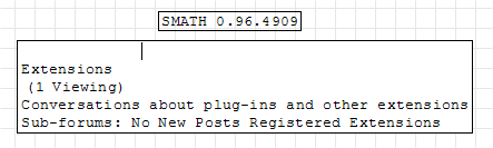

This happens when the clipboard contains strings with spaces (Win7 x64 / SMath Studio 0.97)
P.S. this not happens using the nightly build 0.96.4909

update: I notice the same issue even when I copy and paste a string with spaces from a text area to the canvas (so probably the HTML data is not the cause)

Cannot reproduce on latest 0.97 (tried the same text you shown on screenshot and some others).
May it be caused by some plug-in installed? If you will find it out I hope to find a way to prevent such kind of problems in future.
