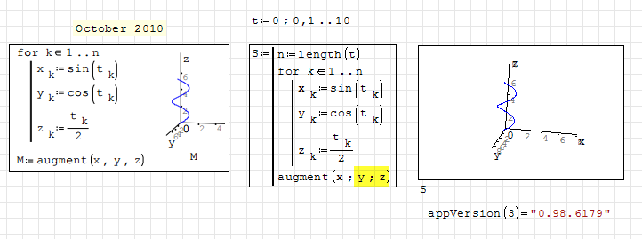

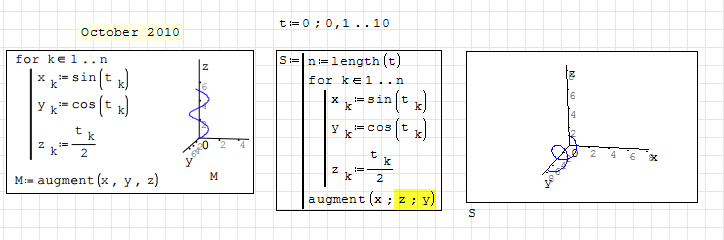

The code 3D Smath 6179 does not correspond to Smath in *PDF [tutor].
Observe the code inversion augment(x,y,z) <==> augment(x,z,y).
Bugs 3D.sm (16,68 КиБ) скачан 1348 раз(а).

Hello Jean,
I can't see differences in behavior, except that in the code you linked above y and z are swapped

Hello Davide,
Always there ! Yes, the 3D plot code are in reverse order.
Cheers, have a good day ... Jean
