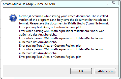

Dear all I'm facing with import problem from Mathcad files, somebody can help me?
The import seems not supporting the plot function and the ceil method
Choke290.xmcd (348,43 КиБ) скачан 1431 раз(а).
Here below the error msg I received:
thanks
Riccardo
thanks
Riccardo
