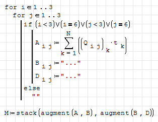

#2 Опубликовано: 17.11.2015 20:50:10
You have to define A,B,D in a loop, then you can merge the matrices using augment(...) and stack(...)

Thank you this works very good.
An alternative is to write the equations into a Matrix and that loop over it:
