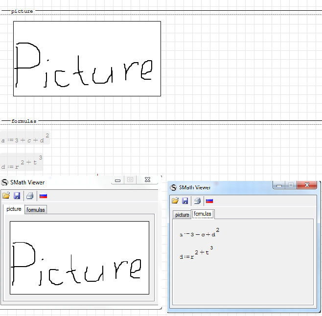

Hello. Please help
On the program sheet I have pictures, a set of formulas.
When I create an .exe file I get it.
But, I would like so that instead of pictures and sets of functions there was something like a button or hyperlinks (or something similar) by clicking on which, I would already receive my picture or set of functions in the form of files .xls, .doc, .pdf or others
Файл не найден. Файл не найден.
Thanks!

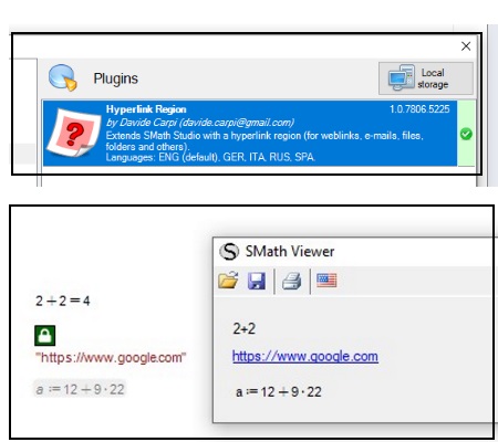

#2 Опубликовано: 18.07.2024 20:05:52
⚜ Kenny Lemens, P.E. ᵂᴵ
85 сообщений из 179 понравились пользователям.
Greetings,
You can use some plugins to create this functionality. For instance, add the 「Hyperlink Region」 to your calculations; this will result in the iconic hyperlink as shown below:
May this be of Good Help;

#4 Опубликовано: 19.07.2024 23:14:10
1 440 сообщений из 2 929 понравились пользователям.
What if you need to link to a picture or file?
You can find the documentation of the region here: hyperlink region
