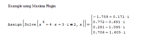

Here an example solved by using Maxima plugin:
best,
Oscar

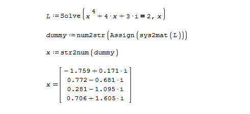

How to put these answers of Maxima plugin inside a vector?

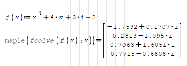

You can use maple() too.
Maple has a fsolve() function.
Which uses floating-point arithmetic.
A little trikiest

Okayy,,,The trick using num2str is so cool..

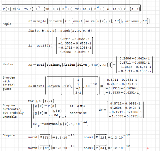

Hi. Another way.
zroots.sm (19,36 КиБ) скачан 1475 раз(а).
