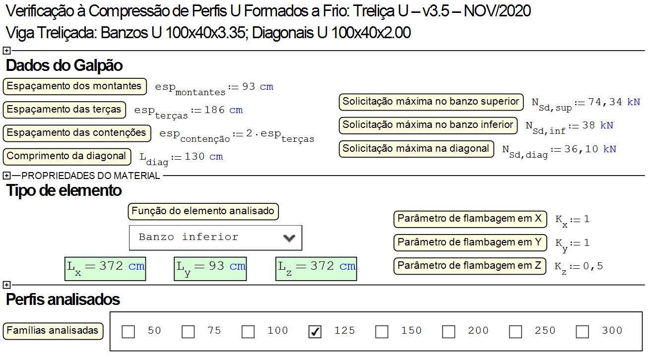

Here I have my script:

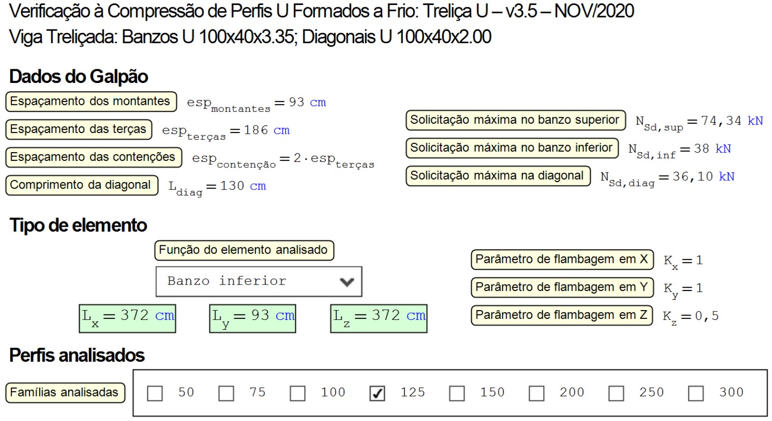

And here I have the PDF generated:
I'd like to remove the extra space above wich section title, where there were area regions.

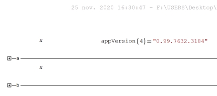

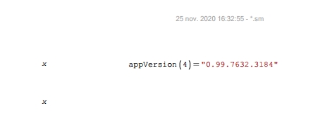

Hi. This behavior seems that happen only with print as PDF. Try to "Save as PDF" instead. Regions appear then in the PDF.
Saving as PDF:
Printing into a PDF file:
