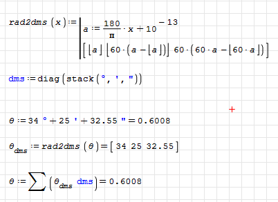

I am a new user to SMath, and a student studying Geomatics. I would like to begin presenting my homework digitally using SMath. We regularly work with problems in DMS. Does SMath allow this type of input?
Lets say for example, I want to input I:= 34° 25’ 32.55” and then continue on to solve a problem and generate an answer that would then appear as DMS?

Hi Desert. This could be a way:
dms.sm (5,95 КиБ) скачан 1779 раз(а).

Alvaro,
Many thanks, this is exactly what I needed. I am getting the results I want.
