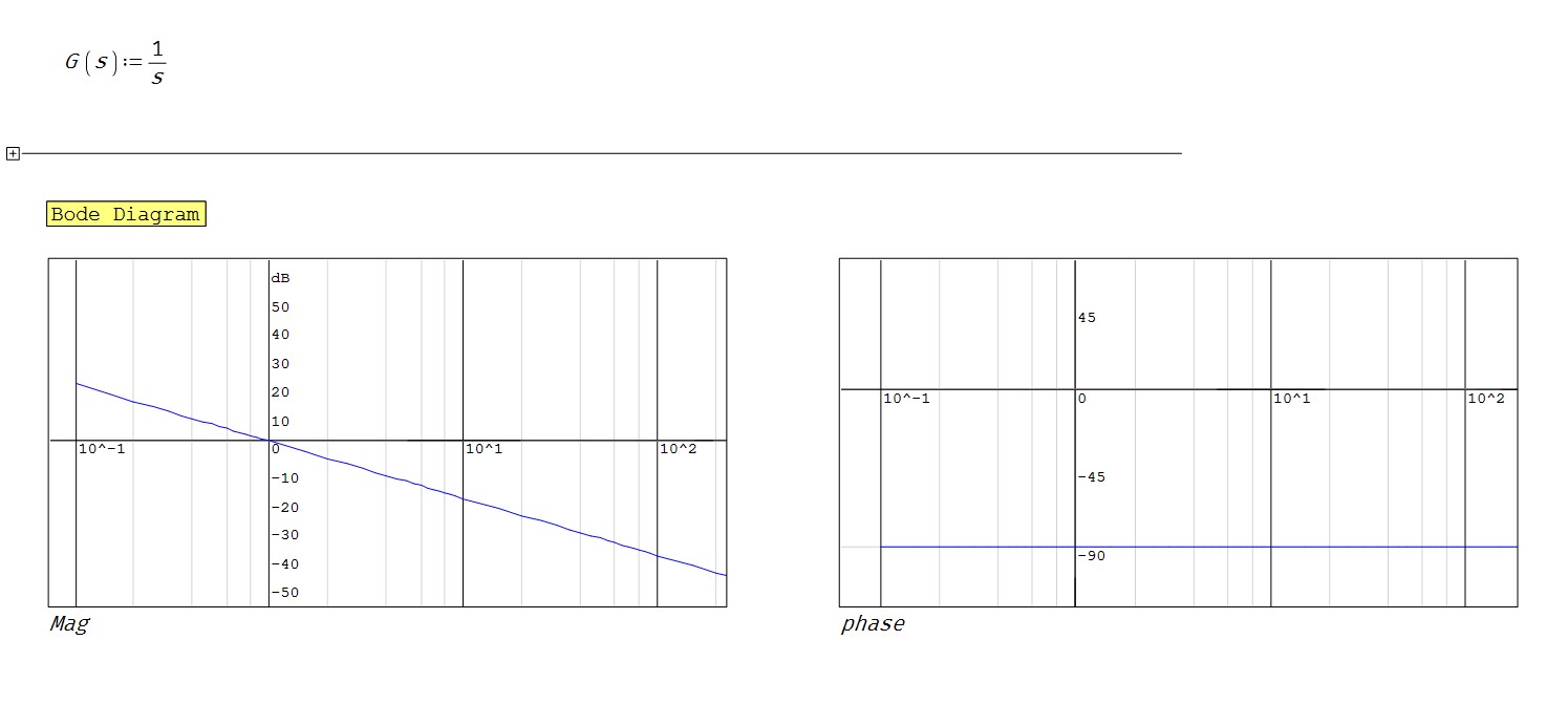

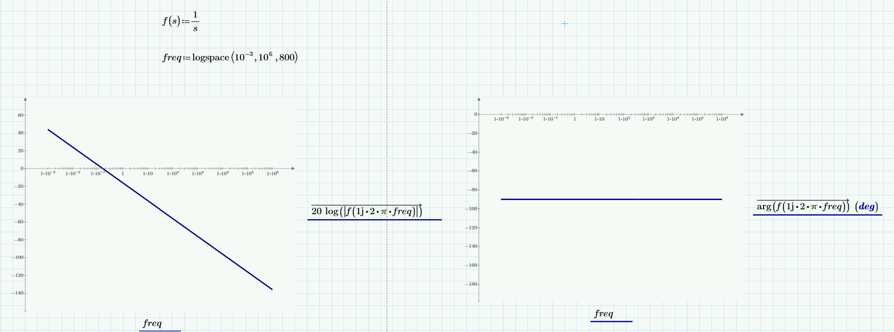

How to make bode plot in Smath Studio like below in Mathcad prime?
Only x-axis is in logarithmic

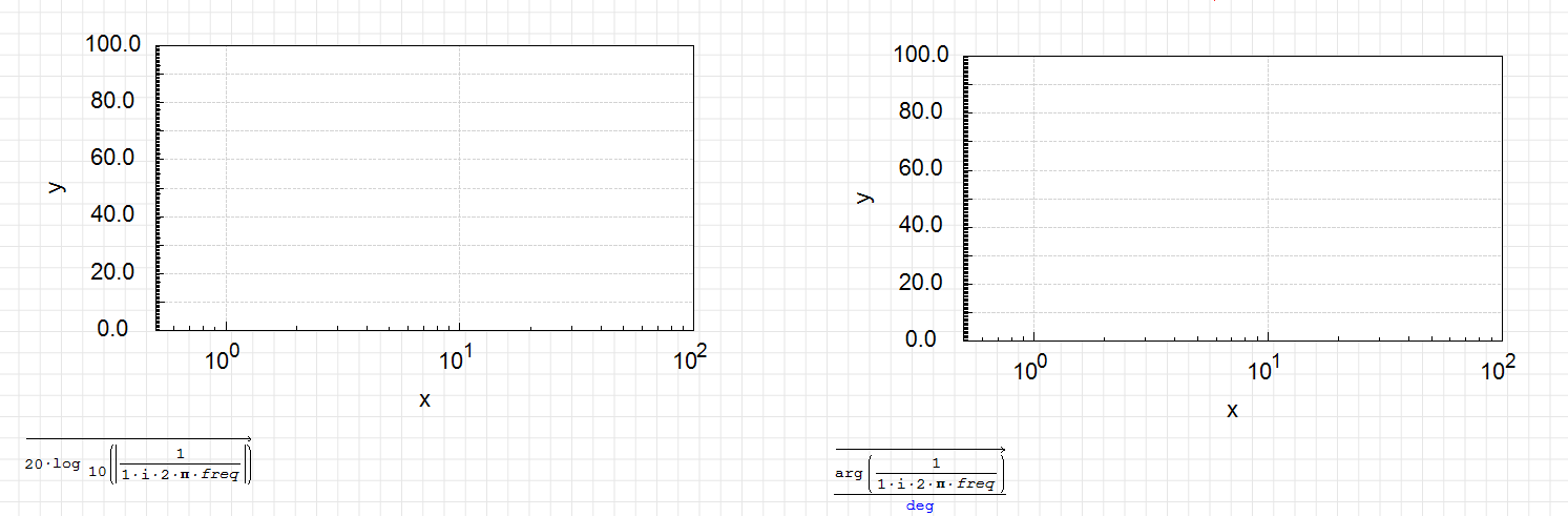

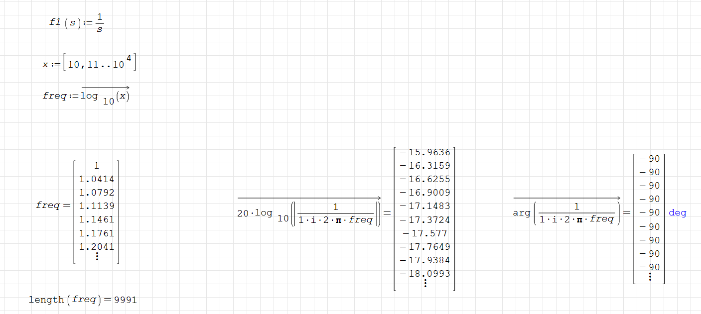

But how can I plot these 2?

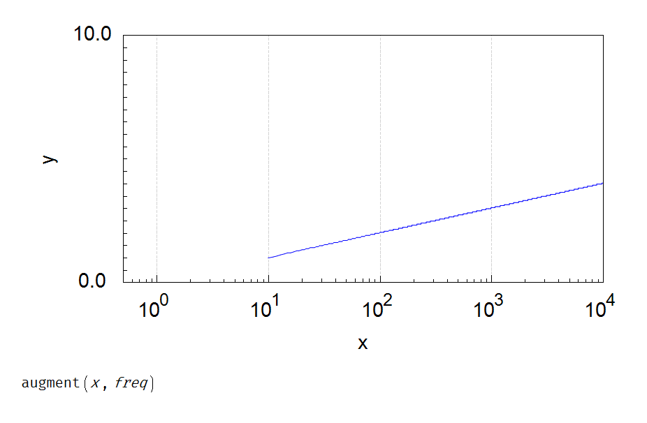

Cornel,
The arguments for a plot must be a function or a couple of column vectors.
I your case you can use in your plot the vectors you are calculated and use as input for the graph:
Best,
Oscar

But I want to plot augment(freq, 20*log()) and augment(freq, arg()), which does not work..this îs the problem
#6 Опубликовано: 23.12.2024 03:30:00
Oscar Campo
Oscar Campo
augment(freq, arg()) and augment(freq, 20*log()) really works... only must adjust the axis... your yaxis is set 0~100 and your data appear in the 0~(-100) axis

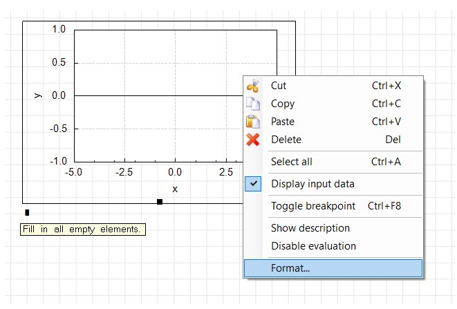

#8 Опубликовано: 25.12.2024 03:40:21
I'm starting to dislike Smath's problems/bug and that is not working continuously fine...[/attach]
Now I am done with being polite.
If you don't like this much, use another program.
