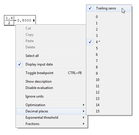

Hello [userlink]m227[/userlink],
have you tried the "trailing zeros" option in the context menu?

Davide, you saved my day.
So this post can be deleted. I don't know how could I omit this, blind am I...
Probably this function should be set ON default?

Most of the times, I would vote for this option [show trailing 0's].
Other times would vote "NO". Option "show trailing 0's" enables to
line up decimal points in data tabulated from calculations.
I think would be possible to setup this as a global option that acts on new regions (like decimal places; tools -> options -> calculation).
BTS feature requesst: SS-2442
