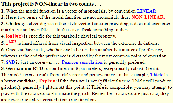

Hello Radovan, let me examine your unsolved examples.
In the mean time, these two examples non-linear are educative for new visitors.
1. solves by itself directly from Cholesky LS solver.
2. is hyper robust from the Smath Genfit module [3 iterates]
F.B. Hildebrand wrote "fitting is an art".
Many broke their nose inventing the art of fitting.
The worst is that each case is specific and the fitting techniques is immense.
All in all, Smath did and surely will do all Mathcad 11,
Can't tell more about PTC/Mathcad "cluster fuck"
None of Paul, Robert, Tom exploded the Mathsoft Proprietary Minerr.
Maybe Viacheslav could do, he is a smart cat enough for that.
Cheers ... Jean.

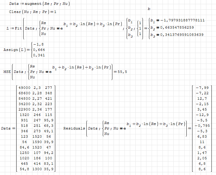

I don't know whether this counts as a reasonable fit, but at least you get a solution.
![2019-02-22 18_58_15-SMath Studio 0.99.6988 - [linfit_multiple-1_Kr.sm].png](/ru-RU/files/Download/h7QzMS/2019-02-22-18_58_15-SMath-Studio-0.99.6988---[linfit_multiple-1_Kr.sm].png)
linfit_multiple-1_Kr.sm (162,77 КиБ) скачан 1323 раз(а).

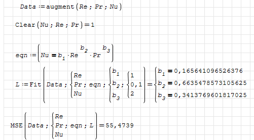

Edit: second example shows the same MSE, and nearly the same b2 and b3.
![2019-02-22 19_29_55-SMath Studio 0.99.6988 - [linfit_multiple-1-1.sm_].png](/ru-RU/files/Download/B8Pzrz/2019-02-22-19_29_55-SMath-Studio-0.99.6988---[linfit_multiple-1-1.sm_].png)

Thank you Martin. It was a direct answer to my question - Fit() function from Maxima. Thank you for reminding us of this once more. Fortunately, we have Maxima plugin for nonlinear fitting (it slipped my mind) and I am glad that I was wrong. I also would have liked to be wrong by saying that this is the only function in SMath performing this task (maple plugin maybe?).
