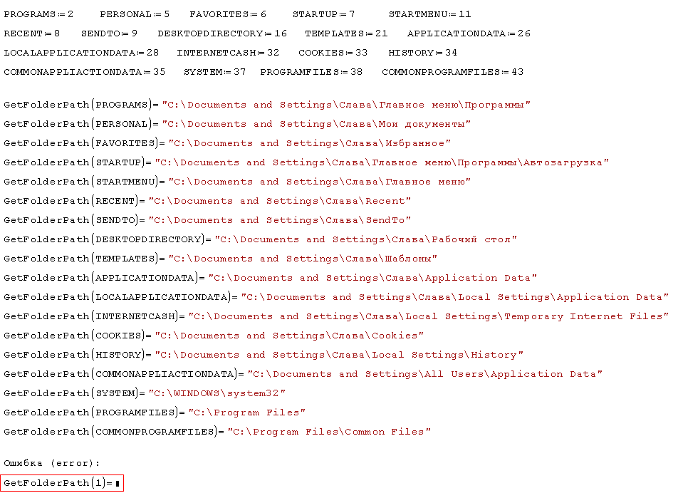

Other functions: CurrentDirectory(), DocumentDirectory(), GetFolderPath(), wfile(3), rfile(2), Play().

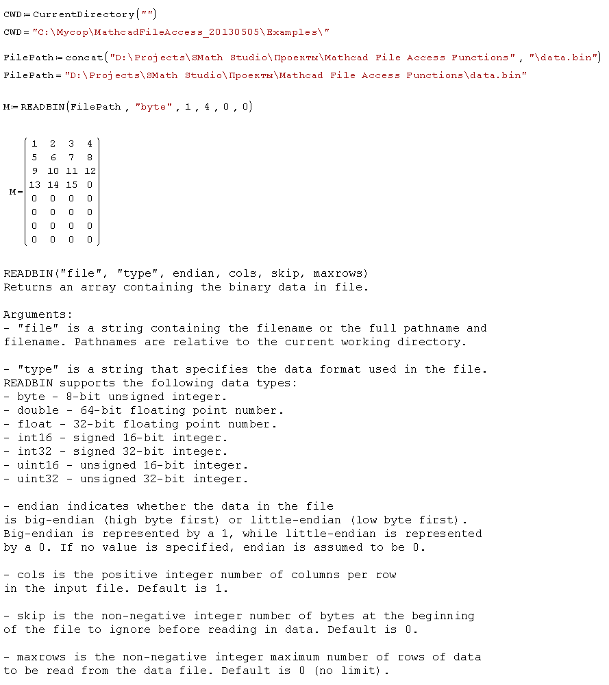

In READBIN(), the last argument specifies the number of lines to read. If set to zero, in Mathcad you get as many lines as the file can give, in SMath you get an empty matrix (good for stacking loop init, as I learned yesterday). If I specify more lines than the file can provide, then in Mathcad the result is augmented by zeros, in SMath I get as many lines as the file can give.

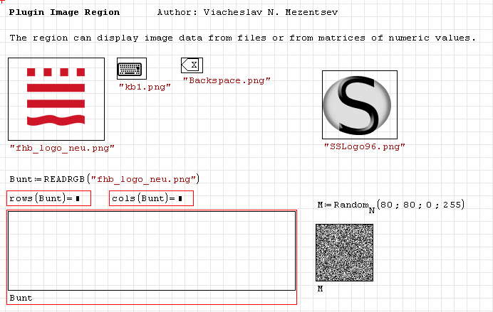

- READBIN: in some situations, changes in the sheet trigger the results to become wrong. Manual re-calculation via toolbar button sets the results back to correct values, but otherwise they persist on the sheet. I attach two screenshots, the upper before re-calculation and the lower after. No other difference between these pictures, just pressed the update button. The sm-sheet is included in the zip. The problem is completely reproducible with the given example.
- READBIN: The docs refer to default values for endian, rows, skip and rows. How is the user expected to adress these defaults? Do you plan to provide READBIN(1) as in Mathcad? What would then be the default type?

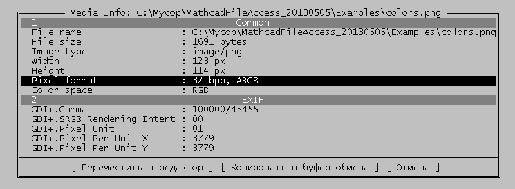

- READ_xxx: These functions seem to insist on 32bpp images, at least, the one in the attached zip fails to be read in. It is a screenshot, which I intended to use instead of the not so colorful school logo.
The image region is not so picky about that, the image can be displayed without problems. However, if a read statement fails and then the result of that failed op is fed to the image, SMath crashes.
Try to update ImageRegion plugin. As for the images. Only two formats are supported for now: 24bppRGB and 32bppRGB (without alpha channel). Your image has an alpha channel (transparency).
I forgot to remove it when copying, but it is possible to have a simplified version of the function.
The update resolved the crash issue. I was irritated by the fact that the read operation did not complain at all, but subsequent ops like asking for the number of rows gave the image format error message. That was due to the default setting of symbolic optimization, i.e. delayed execution of the read op. Obviously, just assigning the result of a read operation to some variable is no read test at all if in symbolic mode.

I have attached a description.
MC15. Reading And Writing Binary Data.pdf (63,46 КиБ) скачан 953 раз(а).

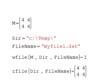

Updated. wfile(3) and rfile(2) added.

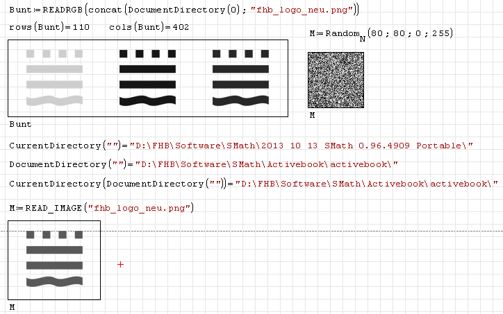

I propose the same changes like here in order to make relative path names relative to the directory of the currently open document instead of the current directory of the system. Thus you could make portable arrangements of data and SMath documents.
Edit: I'd like to also ask for a function DocumentDirectory() which returns the path name of the currently open document. Thus we could benefit from the same improvements with built-in functions like importData.

Updated. DocumentDirectory() added. Try now.

Simply great! Thanks uni. This gives two options: either you build the path for file access ops using concat or you set the current directory to the document directory. This relieves the need for the changes in the access functions, now IMHO having priority "nice to have".
Edit: Don't forget to set file access ops to optimization> numeric. That makes quite a difference in performance.
