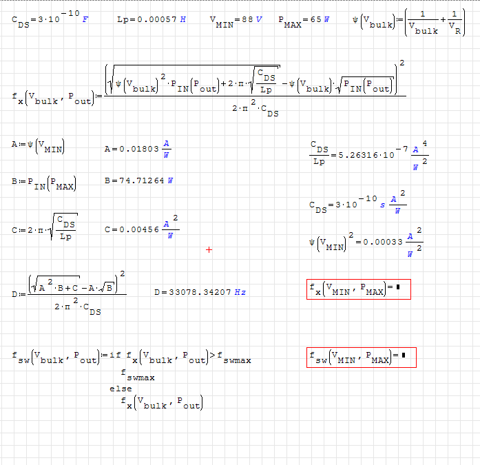

I'm trying a fairly straightforward expression evaluation and keep getting a "Units Don't Match" error. However, the units do work out on paper, and if I deconstruct the expression into smaller variables, and do an expression in terms of those variables, it works out okay. I've attached a screenshot showing the expression, which is a function of two variables. It also shows deconstruction into component variables A, B, and C, and the subsequent D which is the equivalent expression to fx(Vbulk,Pout). The units work out properly to 1/s (Hz) in D, but not in fx, and for the life of me I can't figure out why.
Any help?
Thanks!
#2 Опубликовано: 12.09.2013 15:57:15
You may try the workaround in this post. Perhaps the problem you encountered is related to what was reported in the other thread. Had you attached your sm file I would have tried myself ;-)
