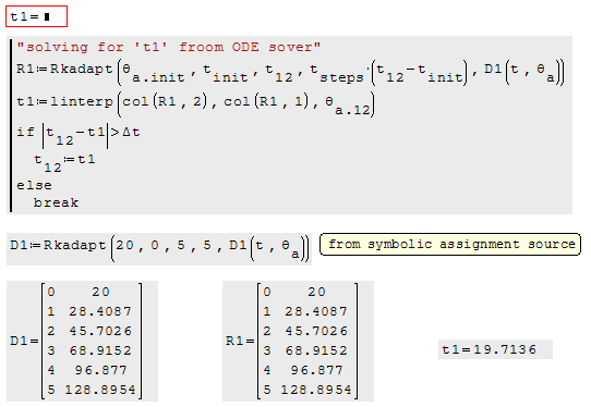

After recently learing how to write for loops, this forgotten project popped back up in my mind again..
My newfound knowledge got me quite a bit further, to the point where i think this project is complete as well.

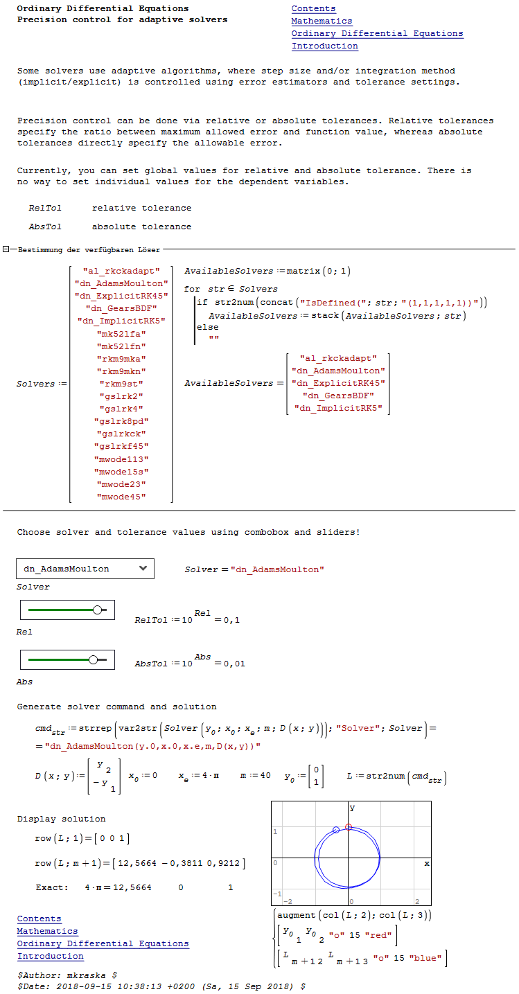

Just one question - is it possible to define a function quickswitchODEsolver(a,b,c,d,e)=ODEsolver(a,b,c,d,e) <-- This could be Rkadapt() for example, or maybe another solver.
Can the 8 different resolutions then be solved by quickswitchODEsolver()?
The goal is to have to change the solver function only one place rathere than 8, if I want to switch.
Cheers.
Temperaturforlop.sm (119,63 КиБ) скачан 1139 раз(а).

Try this https://en.smath.com/forum/yaf_postsm51257_DotNumerics.aspx#post51257
Thanks.
I have tried to apply that approach to selectiong solvers, but my results does not come out correct..
Also, I have tried manipulating ZedGraph setting with the setprop(), but I cant get it to work with existing plots.. only new plots.. any ideas?
Best regards,
Temperaturforlop_test.sm (190,56 КиБ) скачан 1175 раз(а).

#89 Опубликовано: 31.10.2020 21:38:52
Cheers.
There might be smoother ways but this works. Note that I had to replace the sliders because the old regions don't seem to work any more with new SMath versions.
Section Math ODE precision.sm (23,08 КиБ) скачан 1097 раз(а).
Thanks. I already had a go at this approach as uni directed me towards it.
It works fine when I apply it to ODE itself, but when I wrap the ODE into a for loop (a necessity to establish boundary conditions for the whole set of ODEs) something goes wrong..
Cheers

Few comments:
1. As soon as you can plot something, plot ... this is a must.
2. RK solvers are known to over-shoot [Mathematica, Mathcad/Mathsoft ]
3. The Simpson "Premise" is all correct in there.
4. Use solve(,,,,) instead of your other junction.
5. Red top to bottom in SS 6179
Thanks for putting me on a different track.
Solve() also serves the purpose of finding the boundary conditions for DE2-4, although I guess the way I have set it up (might be other ways) does make the ODEs compute a lot of unecessary results (they all go all the way up to t.final, but they only have to go up to t.lim - hence the for loop).
This way the mkraska method of switching solvers work, and it is quite interessting to see the discrepancy in computational times. dn_AdamsMoulton takes way longer to compute, and actually runs into trouble when the tolerances are high..
Any ideas on a setup that stops the DE's when they reach t.lim rather than t.final while still being able to choose the solver?
Cheers.
Temperaturforlop_test_2.sm (92,59 КиБ) скачан 1105 раз(а).
