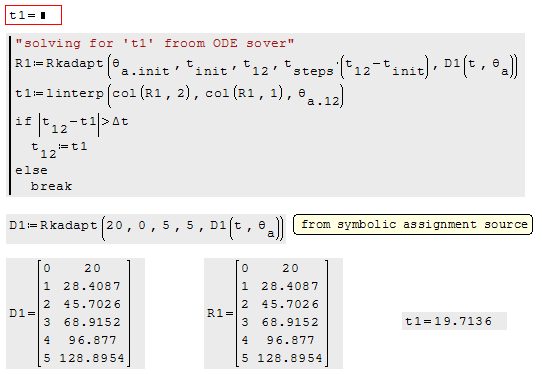

After recently learing how to write for loops, this forgotten project popped back up in my mind again..
My newfound knowledge got me quite a bit further, to the point where i think this project is complete as well.

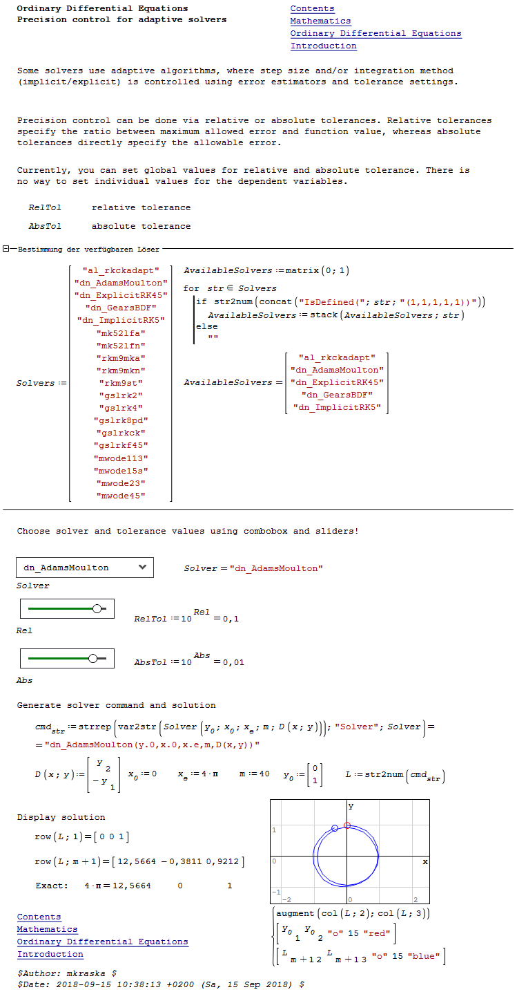

Just one question - is it possible to define a function quickswitchODEsolver(a,b,c,d,e)=ODEsolver(a,b,c,d,e) <-- This could be Rkadapt() for example, or maybe another solver.
Can the 8 different resolutions then be solved by quickswitchODEsolver()?
The goal is to have to change the solver function only one place rathere than 8, if I want to switch.
Cheers.
Temperaturforlop.sm (119.63 KiB) downloaded 1139 time(s).

#86 Posted: 10/31/2020 1:16:19 PM
1,558 likes in 1,868 posts.
Also, I have tried manipulating ZedGraph setting with the setprop(), but I cant get it to work with existing plots.. only new plots.. any ideas?
setprop() is experimental and I will add differ method to control region properties (using math variables as values for them). Yes, now it works only for new plots with 'zGraph' name. But you can't save this value with the document. This is because region has binary content in xml file and for now I can't change it by adding new properties.
I am not the author of the component, so it is difficult for me to modify it.
As for the solver I hope someone can suggest a solution.
Cheers.
There might be smoother ways but this works. Note that I had to replace the sliders because the old regions don't seem to work any more with new SMath versions.
Section Math ODE precision.sm (23.08 KiB) downloaded 1097 time(s).
Thanks. I already had a go at this approach as uni directed me towards it.
It works fine when I apply it to ODE itself, but when I wrap the ODE into a for loop (a necessity to establish boundary conditions for the whole set of ODEs) something goes wrong..
Cheers
