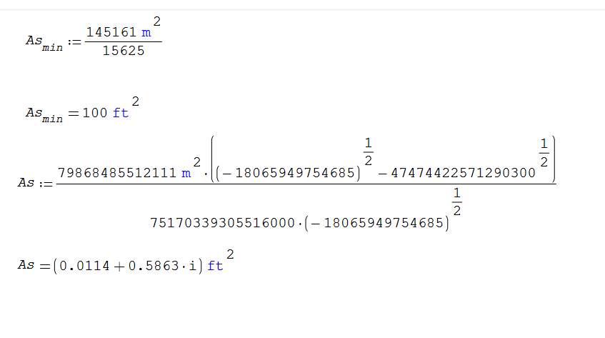

Checking your sm file, by debugging, I found the term As.min is a complex number:
Would you mind checking your numbers?

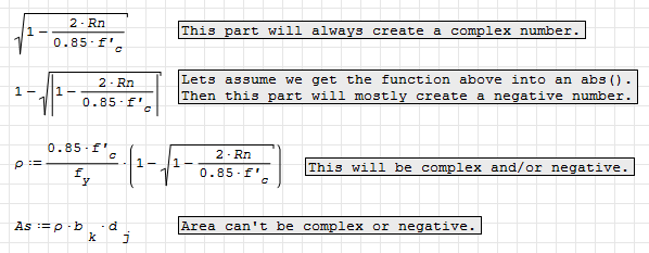

oscampo is right about your functions.
There are mistakes at this algorithm.

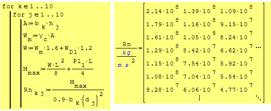

Isn't the double loop should first produce Rn 10 x 10 matrix ?
... then some suite wrt the project.
