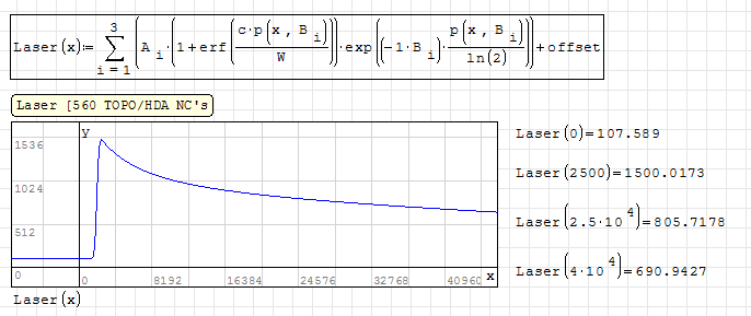

Here, I think the guilty is Smath "erf".
I would prefer be the guilty one.
Any collab is welcome to 'doctor' that one.

No issues I think,
the guilty is 1+erf()*exp() that should be (1+erf())*exp();
Let me know if there are other issues (erf is part of StatisticalTools)

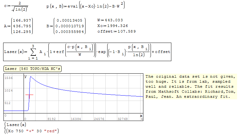

The "laser fit". Quite involved behind the scene.
