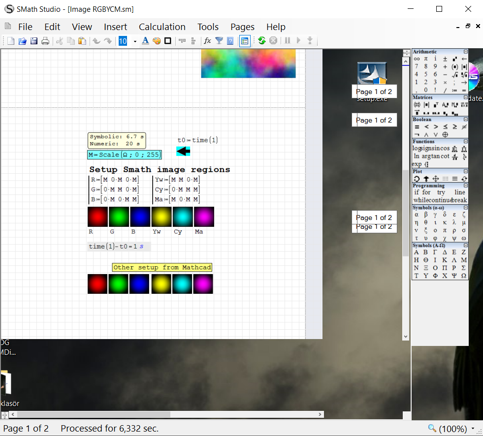

WroteI don't know what is happening but it seems image plugin is ruining the integrity of Smath Studio
I am using Nvidia GTX 1070 with 2560x1440 resolution and 125% text on Windows 10 if it will helps.

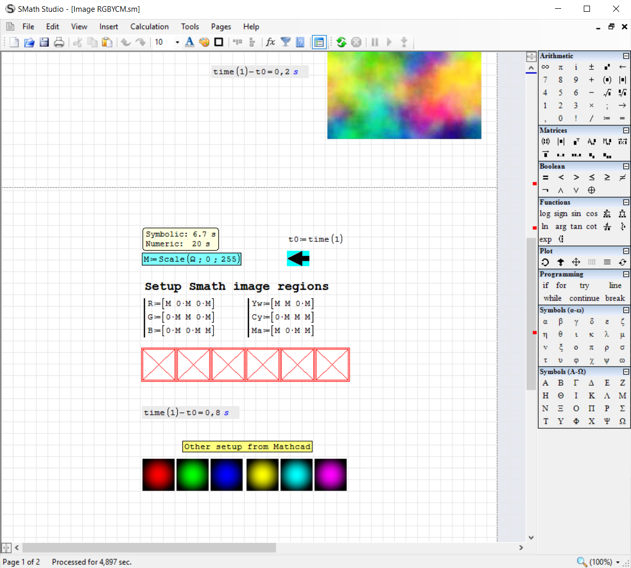

If you get the last R,G,B,Yw,Cy,Ma => the image region is OK.
This is 6179 on Win 7 ... please report for further insight.

I have never said image region is not working, it just scrambles the Smath (6179) window with my Windows 10 display settings.
You can see that on the screenshot below too. Everything is fine if I remove Image Region.
