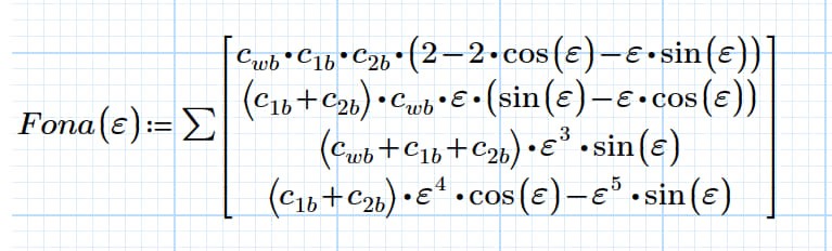

Hello Everybody,
Please, do you have some smarter solutions to write a long formula like this?
I put inside the file my actual primarily range of know-how.
How to compact.sm (13,76 КиБ) скачан 1522 раз(а).
Do you expect some improved solutions embedded in the system?
For instance: one alone split of a line seems in my opinion as being not enough.

I don't have SMath here at work (company policy), but the following technique should work. It works in Mathcad, which I do have at work.
Set the function equal to the sum of a four-element column vector, then split the function definition at the three plus signs that separate the major elements of the definition and drop these pieces into the column vector. Please pardon any typos on my part.
Oscar Campo 27.10.2023 00:12:00, ioan92 27.10.2023 00:22:00

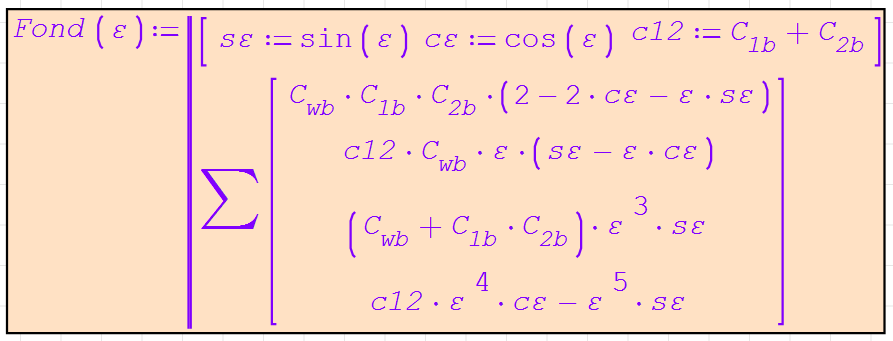

#4 Опубликовано: 27.10.2023 00:34:35
ioan92
ioan92
181 сообщений из 125 понравились пользователям.
Hi NotRetiredYet, Greetings from an AllreadyRetired,
Thank your for your suggestion. It's simplier and it works good:
Best Regards,
Ioan
