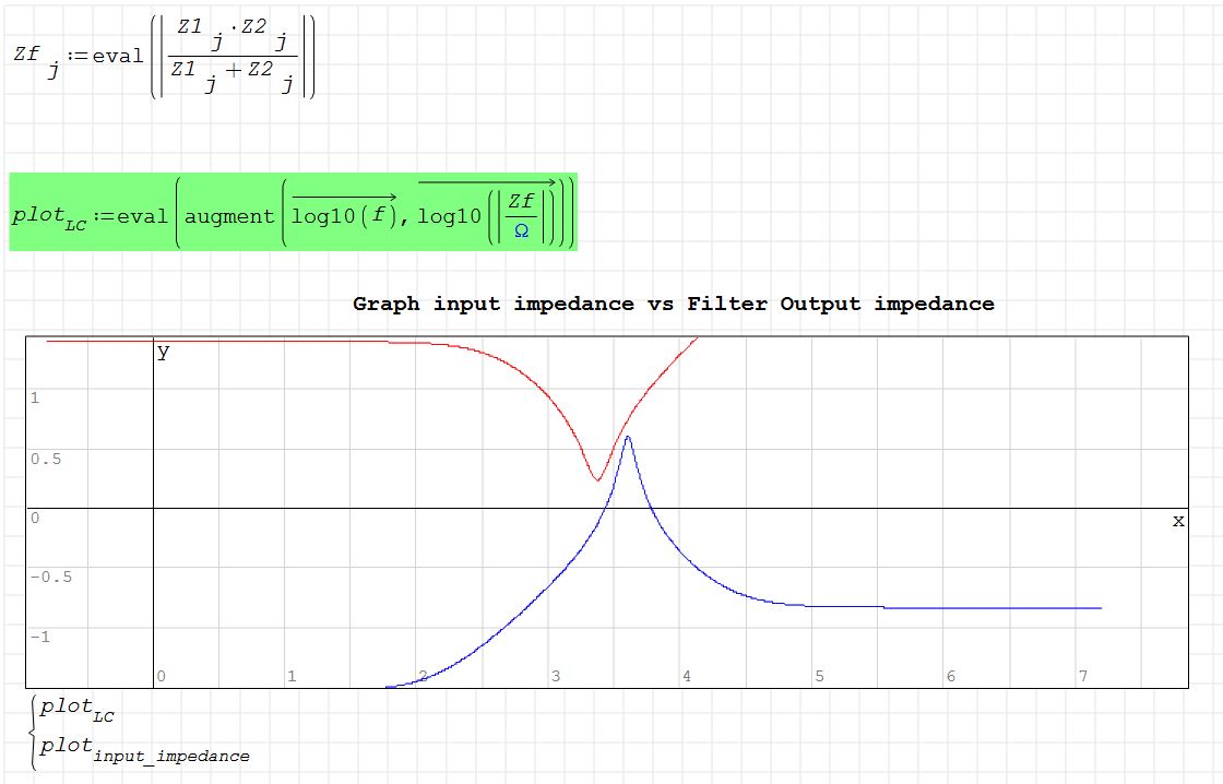

    I am struggling to understand how why my new filter impedance is not graphing
    Does it plot on your SS version ?
    V2_Input_Filter_Test [or like tis in red].sm (69,01 КиБ) скачан 1005 раз(а).

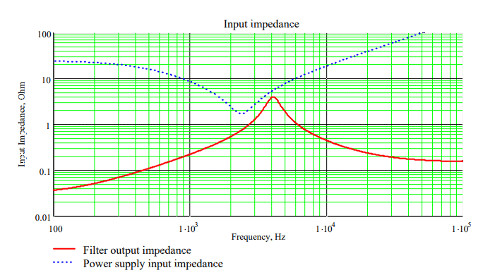

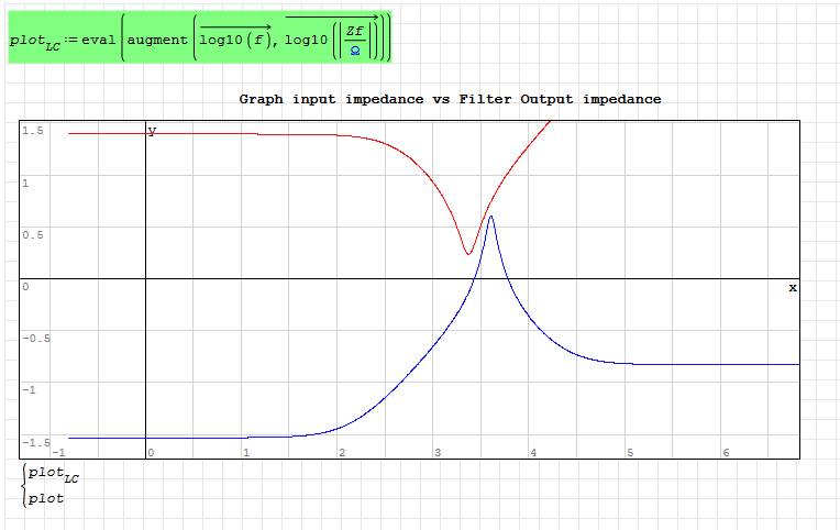

    When I downloaded the version that had those edits it showed that exact graph that you have posted.
    However, whenever I leave the values as i had them without vectoring them get the expected graph, which matches the TI app note. (see picture)
    Input_Impedance_Graph

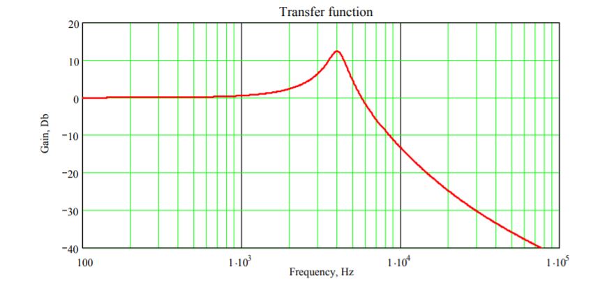

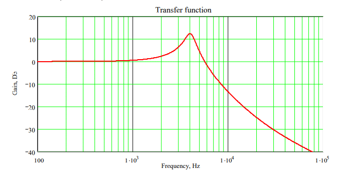

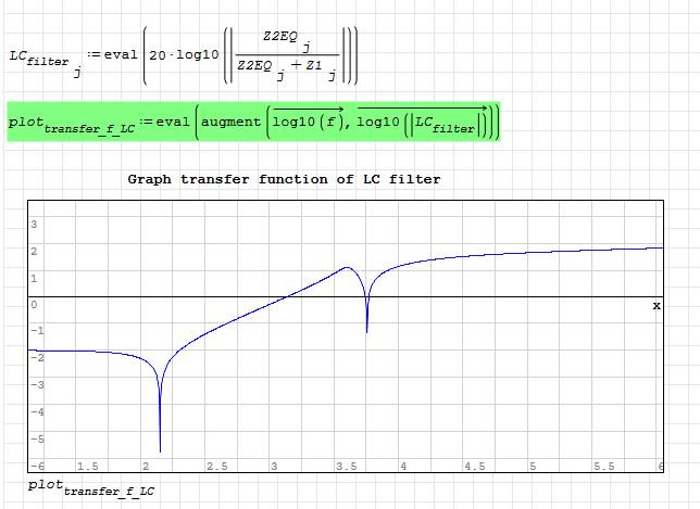

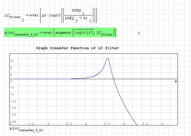

    Now what really confuses me the Transfer function plot looks so different. I input it as the App note stated however the graph seems "negated" as opposed to what I would expect.
    Questionable Transfer Function
    Proper Transfer Function
    Any Ideas Ya'll?

    #6 Опубликовано: 21.01.2020 10:35:03
    Any Ideas Ya'll?
    Same as the other one ... see reply.

    #7 Опубликовано: 22.01.2020 15:07:02
    1 125 сообщений из 1 799 понравились пользователям.
    Hi Carlo. You take twice log10. Just augment log10(f) and LC.filter.

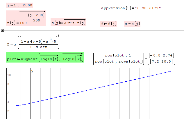

    Hi Alvaro,
    I believe that is what I did? (seriously asking here) See picture
    #10 Опубликовано: 23.01.2020 02:09:22
    Hi. Not in that plot, in the previous:
    Bad: Two logs:
    Ok: One log:
    This other have the same shape, and seems to have the same values than the mathcad plot in the TI app note. Notice that this plot is log only in the x-axis, and the y axis isn't in the log scale in the plot just because you're plotting in dB
    The last plot is log in both x and y axis. See the difference in the green lines. So, you correctly take there here log for both axis
