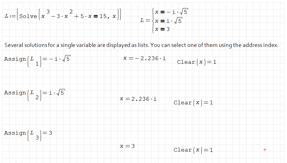

hello everyone
now I am studying SMath with SMath Studio Handbook by Dr. Martin Kraska.

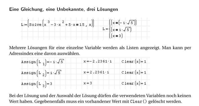

this is SMath Studio Handbook page 110.
this is my result. 40page of SMath Studio Handbook_4 Mathematics.sm SMath Studio Handbook_4 Mathematics.sm (839,5 КиБ) скачан 1775 раз(а).
result is wrong.
I copied and pasted it into another file and the result is exactly the same as Math Studio Handbook.

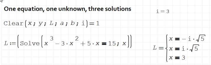

i don't know what is problem.

In the main document you somewhere re-defined i. If you include i in the list of variables to clear, everything is fine.
BTW, You seem to have put a lot of work into the SMath-representation of the handbook.
Have you had a look on the Interactive Handbook? A set of interlinked documents might be easier to manage than a huge document (given the lack of templates and outline features in SMath).
