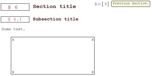

Razonar,
How do you start from paragraph 1? preferably 0?
Thanks,
Basile
PS. Can this be extended to have an automatic Table of Contents, List of Figures, List of Tables, and List of Equations?
Thanks,
Basile
WroteRazonar,
Thanks,
Basile
Hi Basile. You can start from any paragraph pointing the value of the variable '§, for example from paragraph six is: '§:mat(5,1,1)
For paragraph 1 use zero as starting value.
Yes, I it's possible automate the TOC, but I don't know how to catch in the SMath document the page number, so, I can do that but manually adding it. Index at the end of the attached.

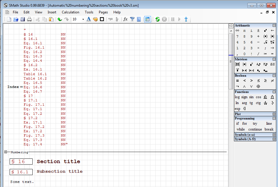

Davide Carpi 01.10.2018 03:25:00
You can display the index at the begin of the document if you assign it to an absolute variable at the end (those variables starting with a tilde ~)
On german keyboards, the tilde has to be copied from a text region as it is catched as a hotkey for boolean = in math regions).
BTW, why don't you use formatted labels?
![2018-10-01 09_58_08-SMath Studio 0.99.6839 - [Automatic%20numbering%20sections%20book%20v3.sm].png](/ru-RU/files/Download/S7nvyG/2018-10-01-09_58_08-SMath-Studio-0.99.6839---[Automatic%20numbering%20sections%20book%20v3.sm].png)
Automatic%20numbering%20sections%20book%20v3.sm (40,27 КиБ) скачан 1556 раз(а).
Hi Martin. Thanks for the update about global variables. I don't use formated labels because I want only to show how get automatic numbering into several SMath documents with native SMath tools. Without any doubt with formated labels it will looks great.
